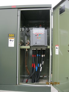

Hi All.
I know I've seen a picture or two of your typical oil filled pad mounted transformer that had fuses or a breaker installed right off the paddles on the secondary compartment. I tried googling it and could not find any.
I've asked our ABB and Cooper reps if they offer and factory installed breakers or fuses and they both said "no".
Has anyone come across anything like this? I realize on the bigger sizes it may be very difficult to do and be able to get several sets of parallel 500's landed due to limited room but there would be some instances where it could be an advantage to "move the problem" from the line side of the switchboard main out to the transformer.
Thanks.

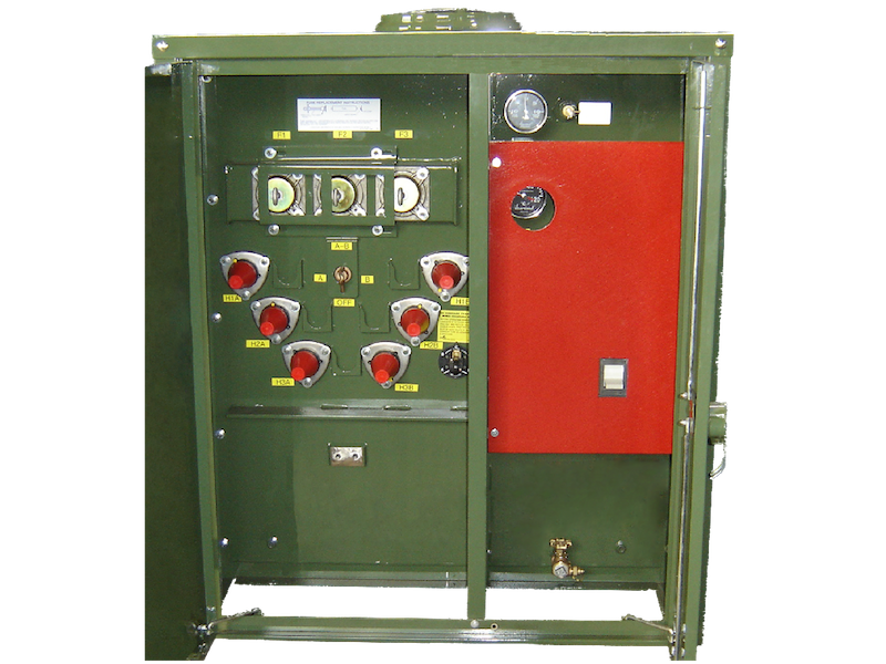

Maybe this is what I saw?

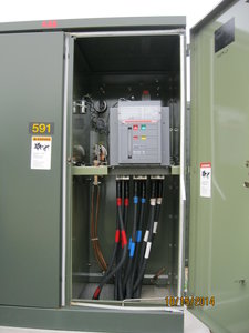

I saw this at a wind farm on a 1750kVA, 12.47Y/575 txf.
That looks like a very good install. Thanks for sharing.

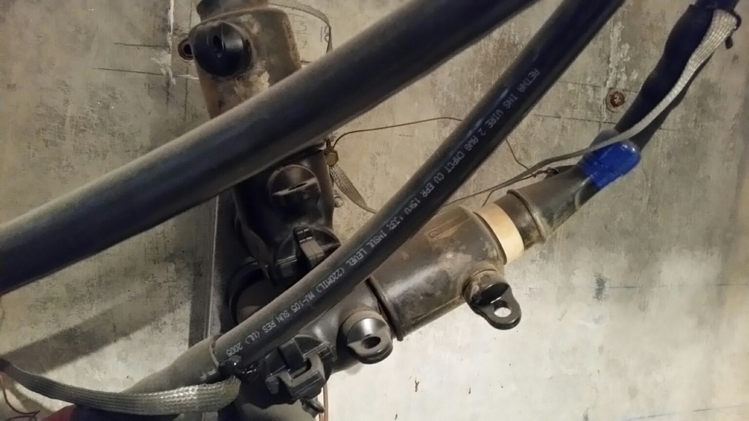

Yes, I'm familiar with all of the above types of primary side fused protection.

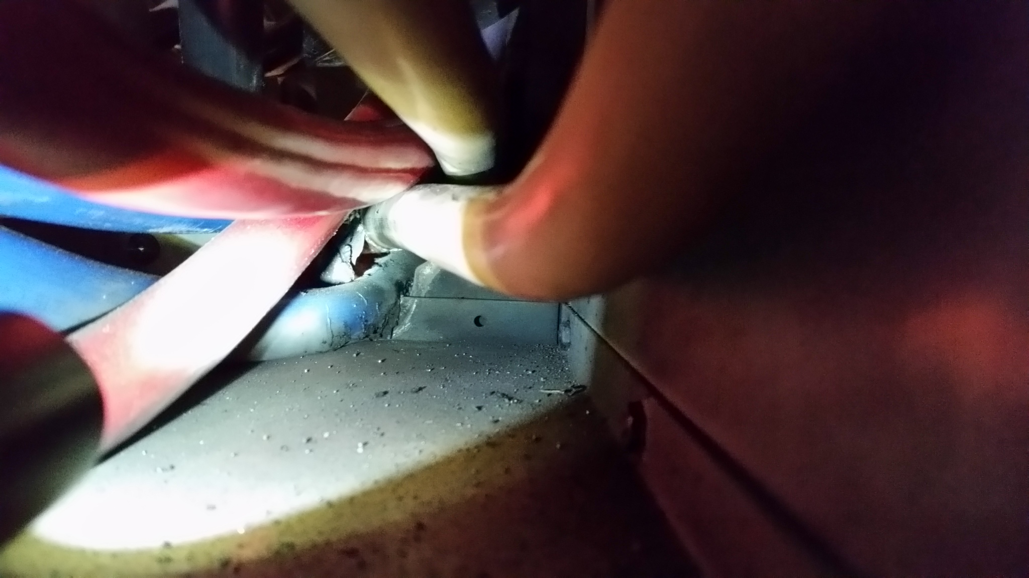

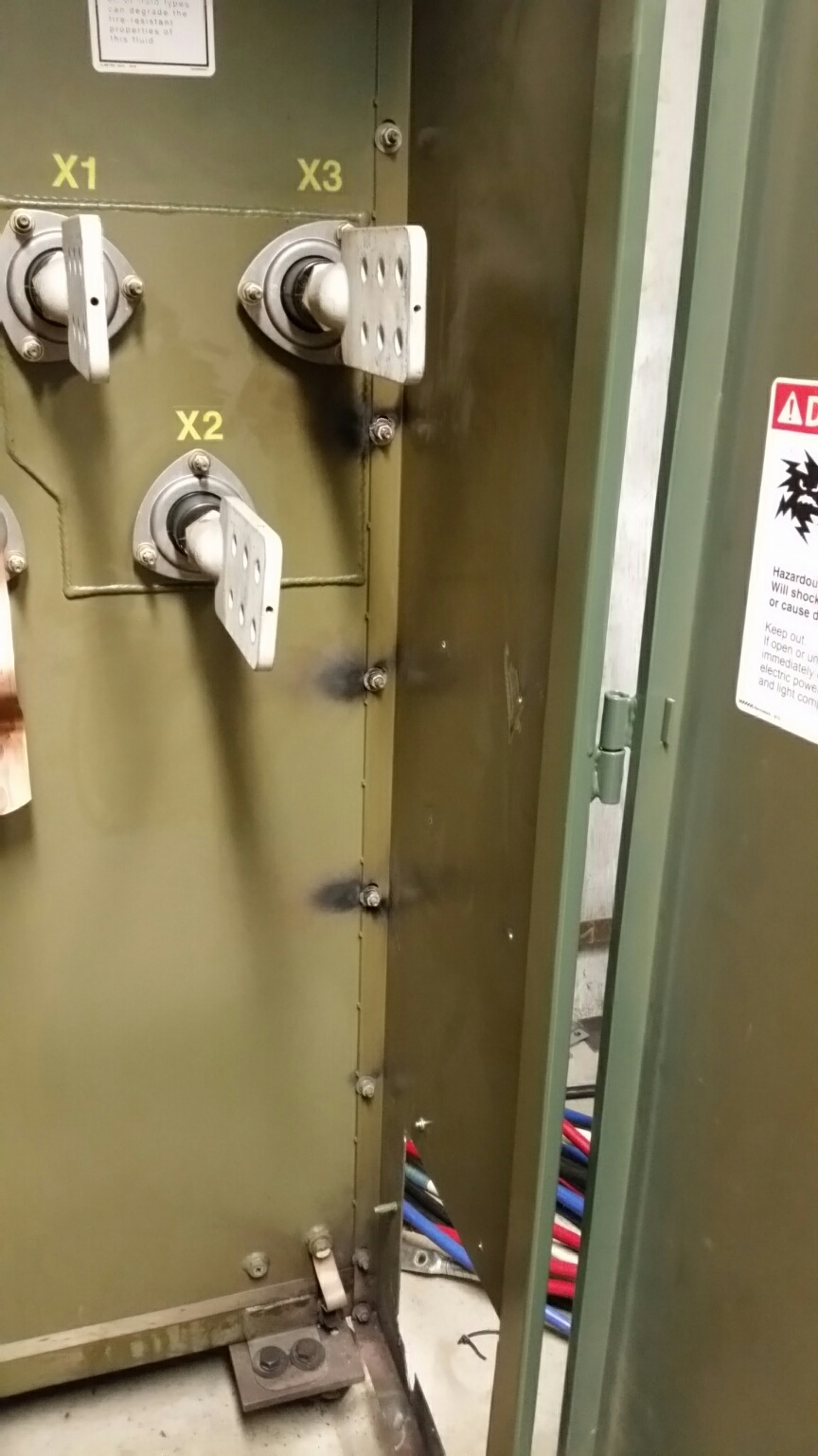

The reason I am asking in the first place is that last week we energized a new 500 kva transformer with primary side bay-o-net fuses AND a programmable VFI on the feeder to the transformer. One of the secondary feeder conductors was nicked and in contact with the secondary cabinet so fireworks ensued upon closing the switch. The primary fuses did not blow nor did the VFI trip. It took a good 5 seconds to re-open the switch. This is a remotely operated SF 6 switch. If we had a secondary side breaker it could have had settings making it more likely to trip.
This is in a vault. I closed the vault door and stood outside prior to energizing. I could hear multiple explosions and see multiple flashes under the door during the event. I expect the actual amount of fault current was fairly low as I can see the fault path through the cabinet at each bolt (the cabinet is bolted on to the transformer tank.) I will upload some pics. NOTE: There was rubber or vinyl trim molding around the cutout in the side of this transformer cabinet and the wireway that was bolted to it. Not sure what happened. It must of come off to some extent while pulling in the secondary conductors.

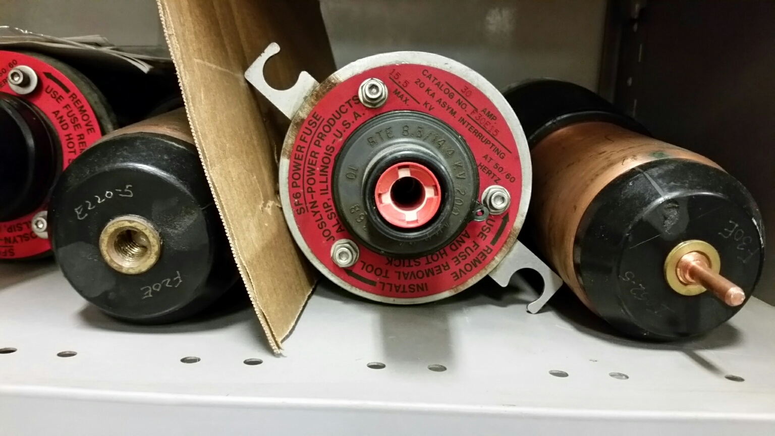

 Post subject: Re: Adding fuses or a CB in a pad mount xfmr secondary
PostPosted: Wed Aug 31, 2016 4:17 am
Posts: 438
Oh, we have a few fused elbows around here too. Plus some old Joslyn fuses you plug on to the 200 bushings then plug a regular 200A loadbreak elbow on to. They don't make that type anymore but we still have several in service. Fortunately we have a good stock of spare on hand. See pics of both types I just happen to have on hand.
Were the secondary cables meggered prior to final connection? That may have spotted a problem prior to energizing.
PostPosted: Wed Aug 31, 2016 5:06 am
Posts: 438
No, they were not.
This was a contractor installed job that I drew. The week prior when they were pulling in the secondaries I was standing there in front of the transformer with the the foreman (on site every day) and his superintendent (stops in once in awhile to check on the job). I said to the foreman "make sure you ring those out" and the super immediately chimed in before I could get another word out "no, I want you to the meg 'em".
I didn't think of it again as this contractor has done a lot of good work for us over several years and visual inspection looked good.
After the incident I the pair if they had tested the cables. The foreman admitted he had not............
None of us will be making that mistake again. I can tell you that.

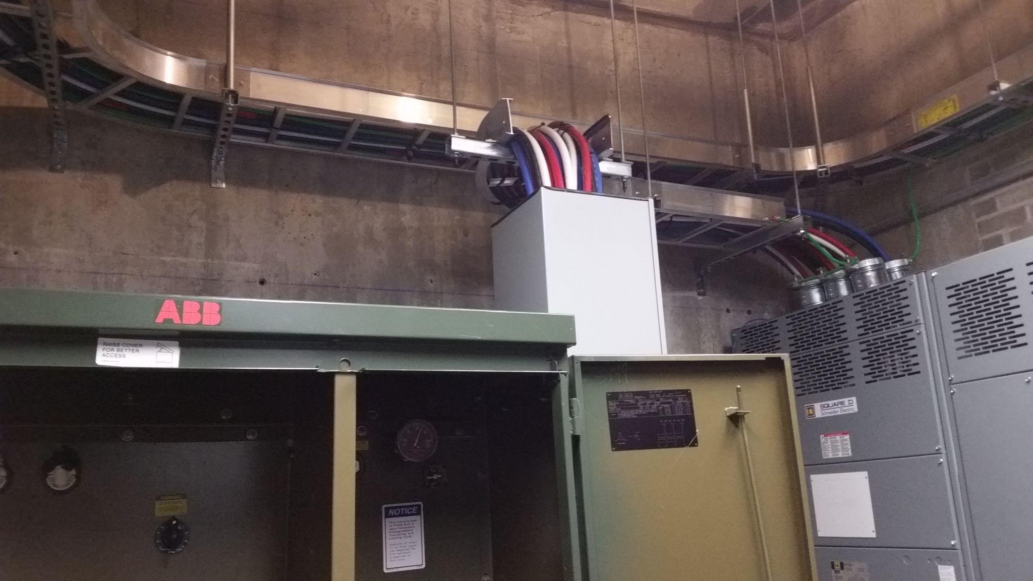

Field modification? Looks like the semi-circular hole adjoining the square one was an afterthought that left a sharp edge.
PostPosted: Wed Aug 31, 2016 9:09 am
Posts: 438
That semi-circular hole was created by the fault, so yes, I guess you could consider it a field modification. Ha!.
Seriously though, although this is a pad mounted transformer it is installed in an existing below grade vault. It would be very costly to bust up the slab to get conduits in from below grade so we fed it from/to overhead. The primary is in cable tray over and down through a conduit. The secondary is in wireway. This pic gives you an idea.

It looks like you have a clearance issue with your secondary gear, or is it just perspective?
Perspective. We have 1" to spare!
