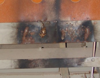

Is this the most recent version?
So please help me understand: A 2500kVA 5.3% 277/480 three phase padmount transformer is feeding a panel board. The voltage puts me in column two. Energized work at the panel requires 40 cal/cm^2 from row 3 and note 6. Work at the padmount transformer terminals, however, requires 4 cal/cm^2, from row 4 and note 1. Does this order of magnitude change in IE make sense to anyone?
