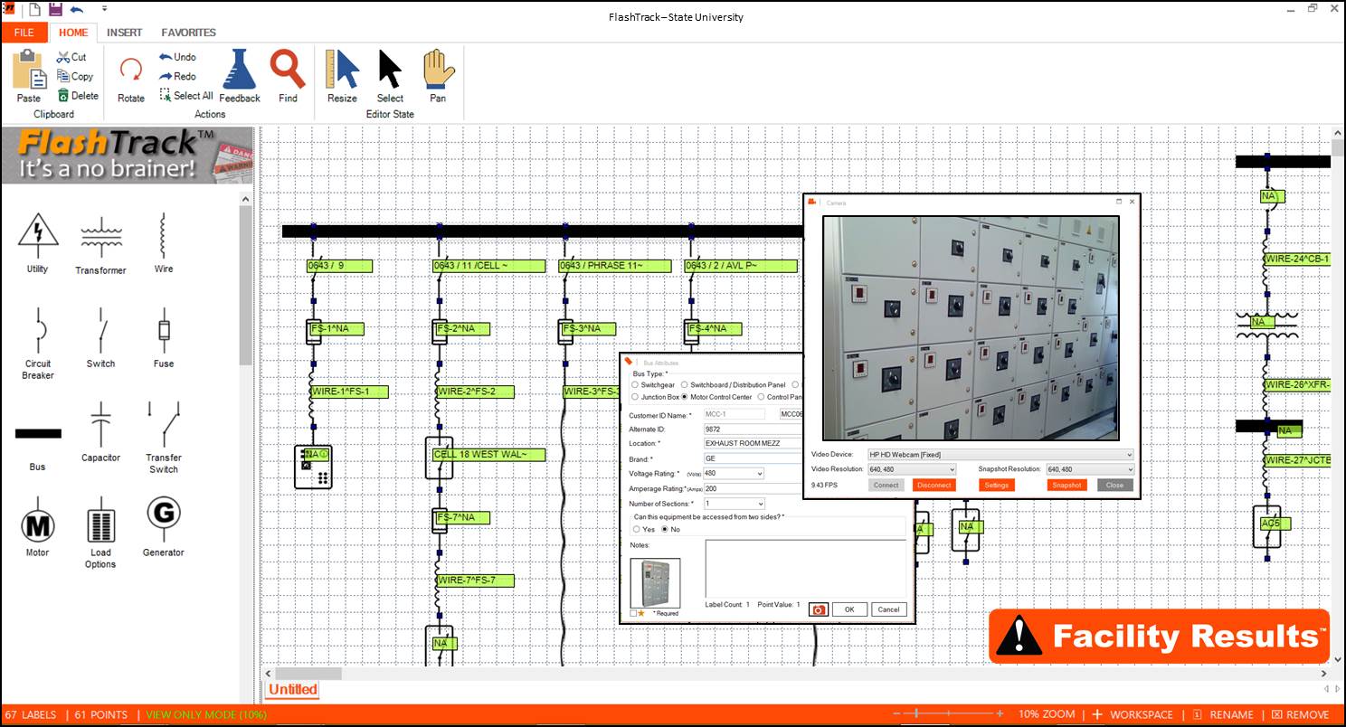

My company is trying to decide which software we're going to use for our studies. They've narrowed it down to etap, Skm, and Easypower. Rather than take the word of the developers they want me to find a real report example from each. Can anyone send me a random sample report from these options?

What I'm looking for is some real world info instead of demos from the software makers. By report, I mean just one or two of examples of short circuit analysis, a form showing the arc flash hazard values, etc, a line diagram, etc. I'm just looking to see how these three groups are approaching this output in a real world example.

Here is a copy of our SKM analysis.
