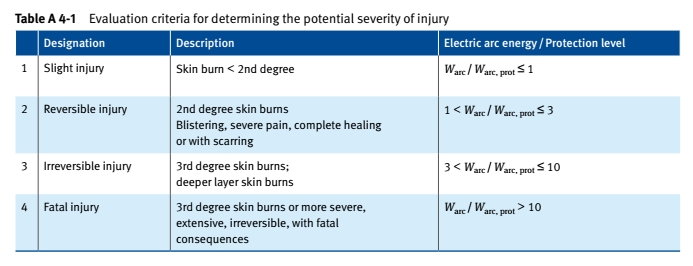

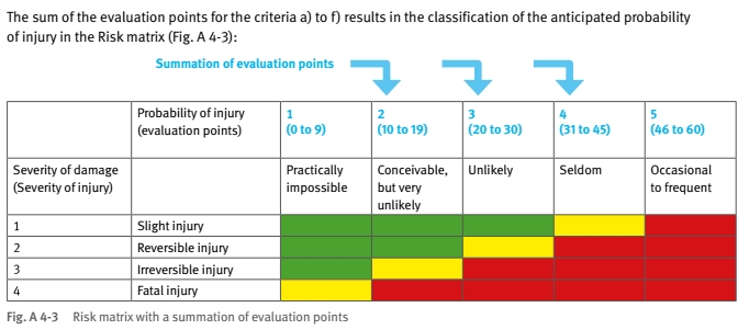

PostPosted: Tue Apr 05, 2022 6:57 am
Joined: Tue Mar 05, 2019 5:47 am
Posts: 14
If this is still interesting for anyone I did recently study for 4 sites where I did double work with latest DGUV and IEEE1584 and conclusions are :
- DGUV returns much more conservative results than latest IEEE1584-2018
- comparing to IEEE it is much harder to make improvements as DGUV goes almost all the time down to 50% for Iarc ( like max power method) and this makes it much harder to control with protection settings - at least in my view and experience
Now from interesting topics :
- As far I read back DGUV 203-077 was started as apparently in EU we need 100% protection against anything and it was opposed against 50% factor in ATPV or EBT50 test
- well in DGUV203-077 from 2021 there is interesting part with risk matrix = severity x probability (not new)
What is interesting is that for severity ( table A4.1) it gives relation between Arc energy and PPE arc energy ( Warc/Warc prot) which might be up to x10 factor. If I got it right (attached screenshot) if I had (very unlikely) level of probability I can have calculated energy 3 x bigger than PPE. Simple example will be : If calculated energy is 960kJ and APC2 = 320kJ it normally will mean that I have no PPE . Now if we implement risk matrix that says that for unlikely event and reversible injuries we can use APC2 as it fits x1 to x3 (50% factor in ATPV and 0% in ELIM ?)
I wonder if someone look at it ?
