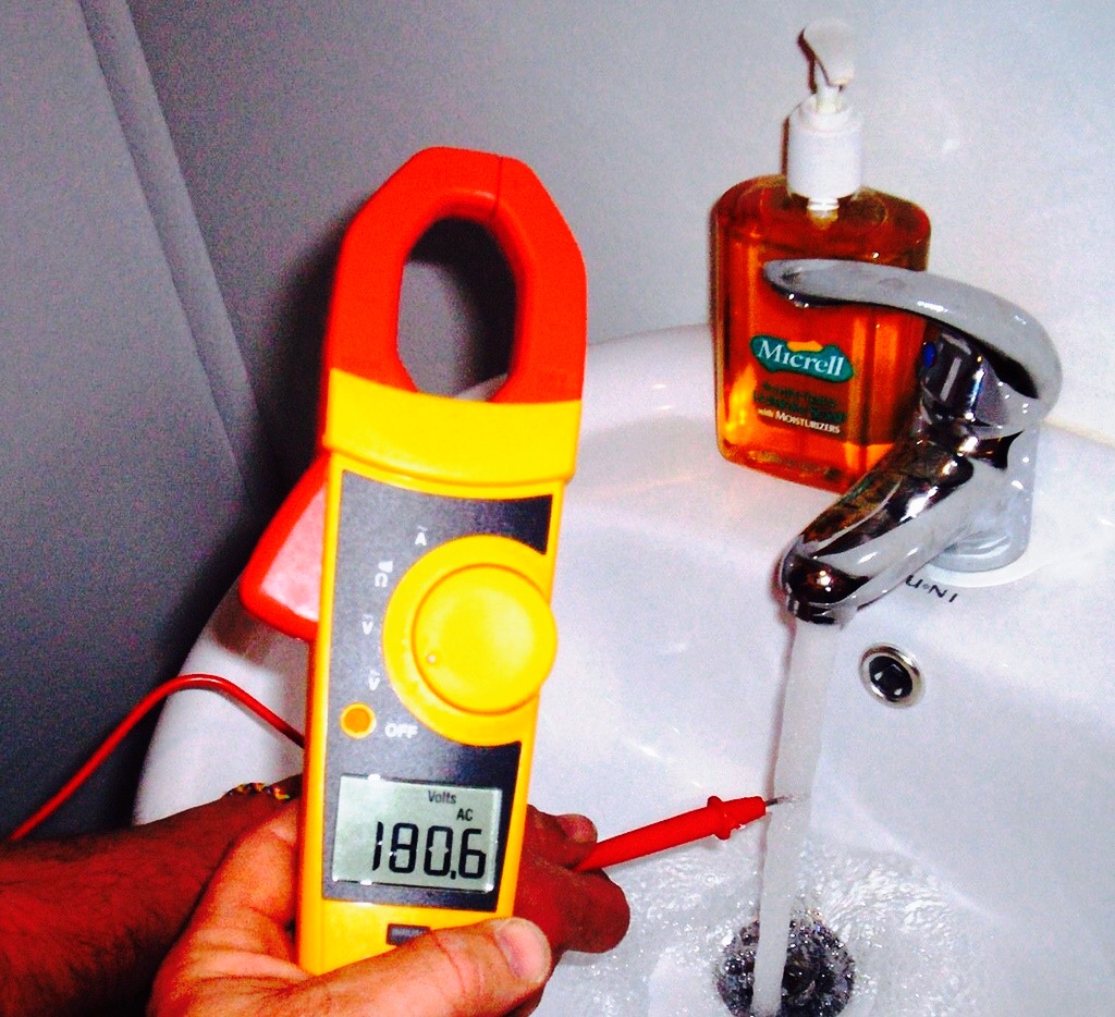

:o We found this in many bathrooms on more than one site. How can this be explained?
File comment: Found in a bathroom at Camp Victory in Baghdad, Iraq.

Floating voltage?

Posts: 253
