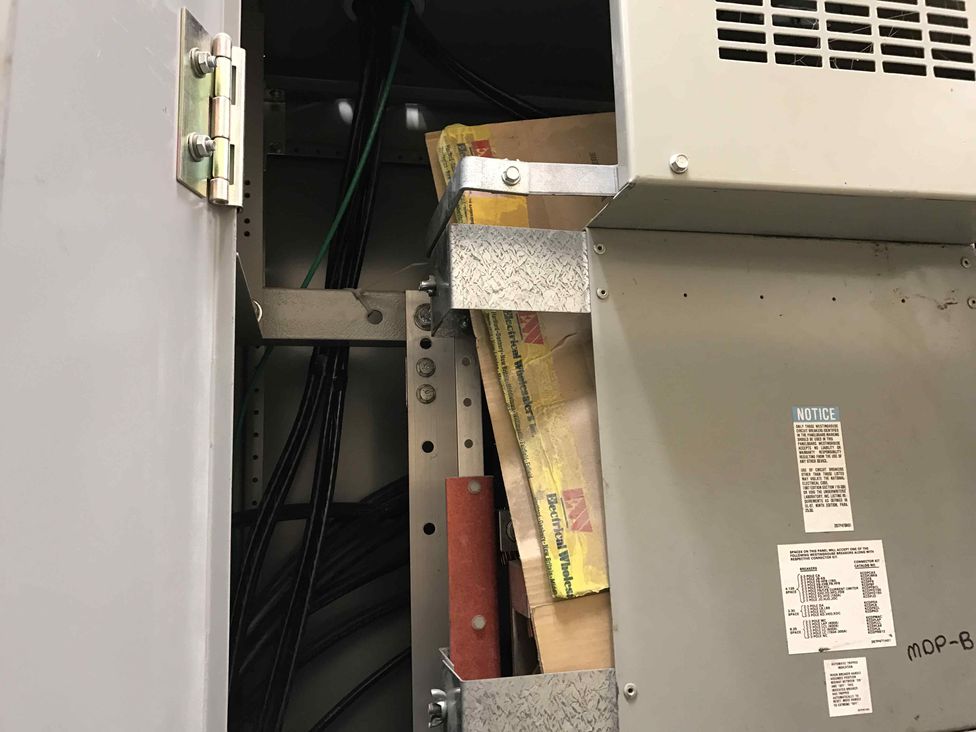

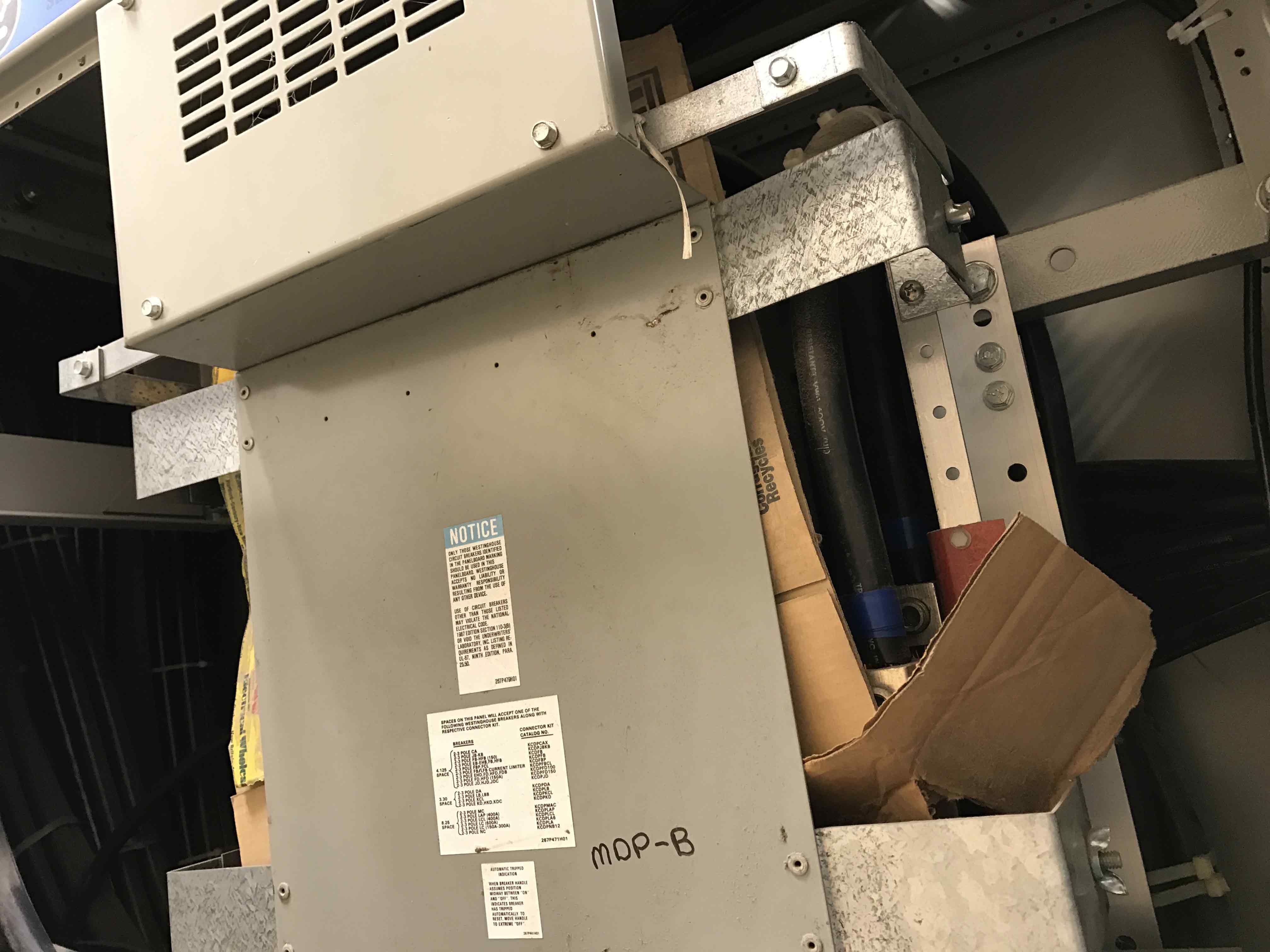

Just never know what you will find when you open a panel.
Apparently this is a method to isolate the conductors from touching the panel

It seems to have worked didn't it? Is that in the NECA manual?

I wonder what the creepage and flashover ratings are for cardboard.

I believe that is called cardboard-clad switchgear!
