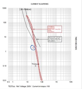

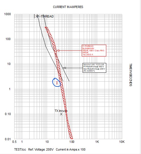

 Post subject: Re: Thoughts On 240V & Less Calculations
PostPosted: Fri Apr 28, 2023 7:55 am
Posts: 30
Last reply, for now.
Has your model produced longer clearing times than 0.5 seconds / 30 cycles for the subscribed conditions? If not, there would not seem to be an issue. In SKM you can set a max clearing time. I assume you can do the same in ETAP and EasyPower.
Thanks for the response bbaumer. Yes, I am aware that you can set max clearing time, however the issue is setting the clearing time at .50 when a fault at a particular bus will not clear that fast. I agree, I dont know how sustainable an arc will be at the low voltage, but what I do know is if a secondary bus is relying on the primary OCPD to clear the fault, it likely won't happen in .5 sec. The attached TCC shows a 112.5 KVA with the primary fuse. The 208-volt bus arcing fault current is about 2600 amps. It is obvious that a secondary fault will not clear at .5 when relying on the primary fuse to clear. If someone was to get injured and you were sued, how could justify a blanket statement of all low voltage clearing times should be set to .5? In this case with a 2 sec clearing time its at 8 cal/cm2 and at .5 its at 1.5 cal/cm2.
PostPosted: Fri Apr 28, 2023 8:40 am
Posts: 486
I understood your question and application and your example TCC, but again, is that from your actual model? Do you even have any 112.5 dry types in the actual facility in question?
I agree with you that I don't think "arbitrarily" capping a clearing time at 0.5 seconds is a good idea but before I made a big deal out of it with the customer I would create the actual model and evaluate the results, with and without the 0.5 second cap. If the results weren't significantly different I would ignore the instruction for the cap and if they asked, I'd tell them I didn't need to cap it as the results were close to the same. If the results were significantly different and the calc'd energy was much higher than the capped I would bring it to the customer's attention and go from there. If they insisted I would put it in my reports and recommend against it.
Also, for what it's worth, I don't normally put labels on dry types that don't have doors (which are by far the majority) as they are not typically a piece of equipment that is likely to require inspection, testing, maintenance etc. while energized so I exclude those from the labeling.
I would definitely be looking for an issue at the secondary side disconnect or panelboard being fed from the transformer and proceed as mentioned above.
I suspect they had some consultant at some point in time tell them the IE was 103.2 calories/cm^2 at the line side of a 30 amp disconnect fed from a 15 kva transformer with 300' of #10 in between and decided enough was enough and instituted the 1/2 second cap policy.
PostPosted: Fri Apr 28, 2023 9:40 am
Posts: 30
Yes this is from an actual model. When I referenced first bus, that is the downstream panel or disconnect as we do not label dry type transformers either.
