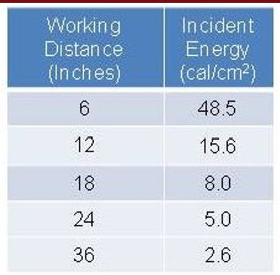

The other approach could be that I would proceed with the job and wear daily wear PPE (20+ calorie jeans, leather boots, 8-12 calorie shirt, 12 calorie arc rated gloves, and safety glasses) and stay well away from equipment, never entering the limited approach boundary if at all possible and absolutely do not enter the restricted approach boundary. Incident energy drops quickly with the square of the distance away from the equipment. For example, an IE of 8 calories at 18 inches is only 2.6 calories at 36". I would use that logic for most of the distribution, but not for large, 480V equipment fed from transformers over, say, 500 or 750 kva without some type of protection at the transformer secondary, especially in a smaller room. More on this later.
