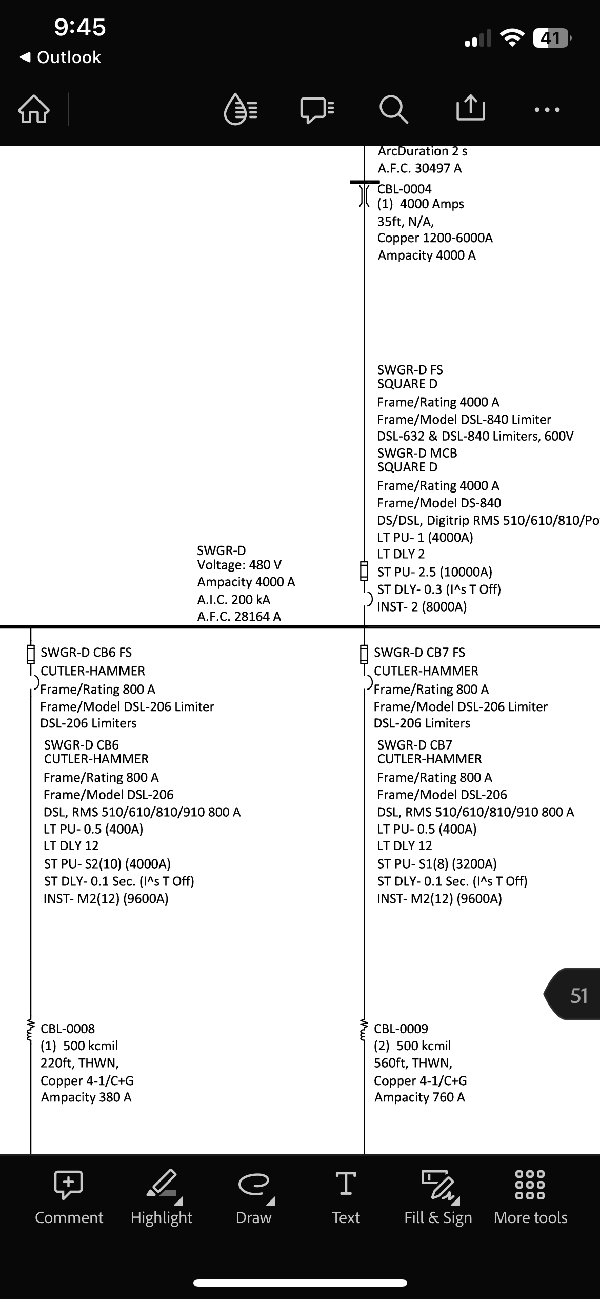

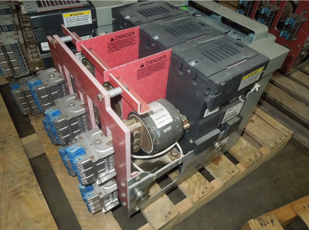

How do I model a Fused circuit breaker in SKM? The breaker is 800A Cutler-Hammer DSL-206.

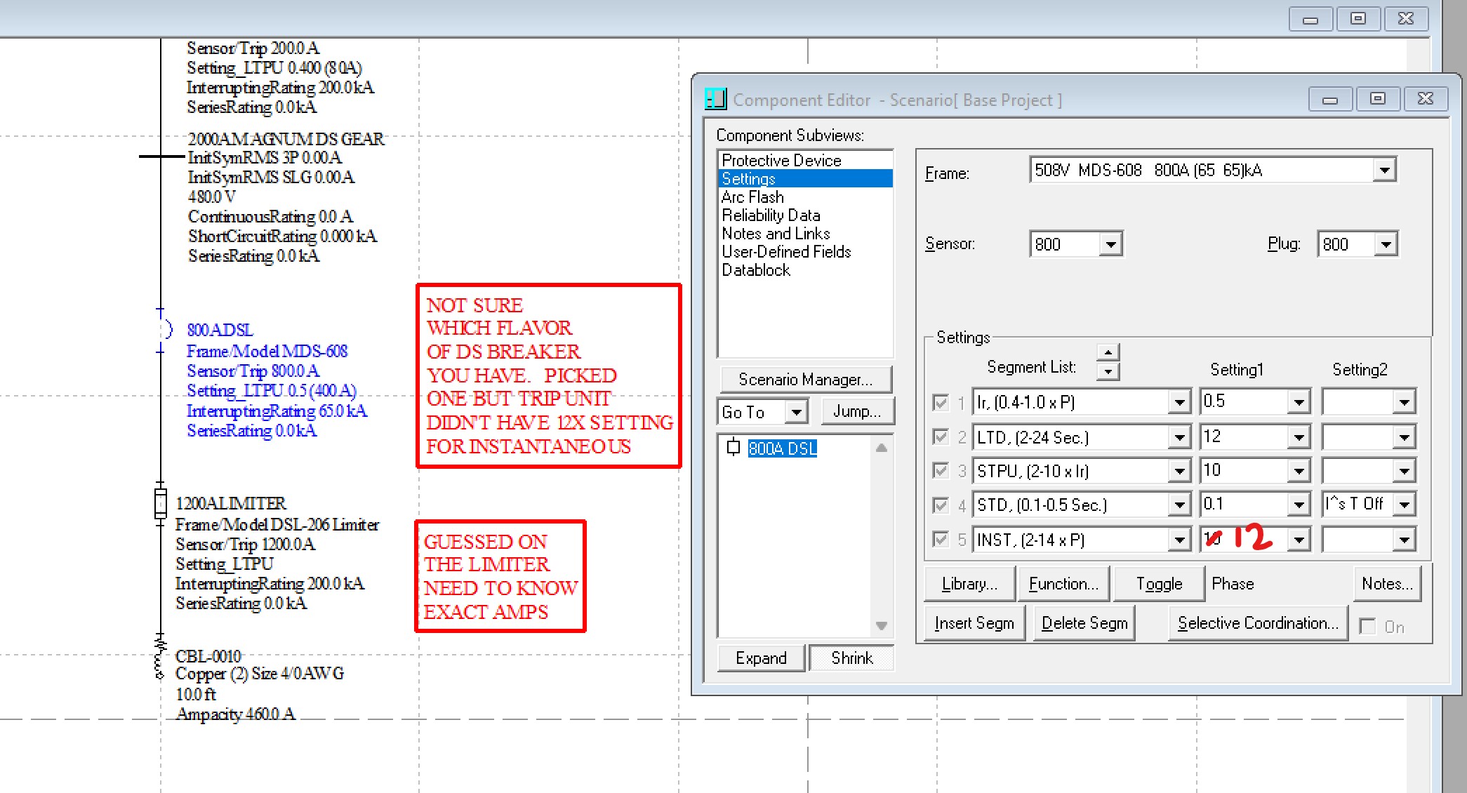

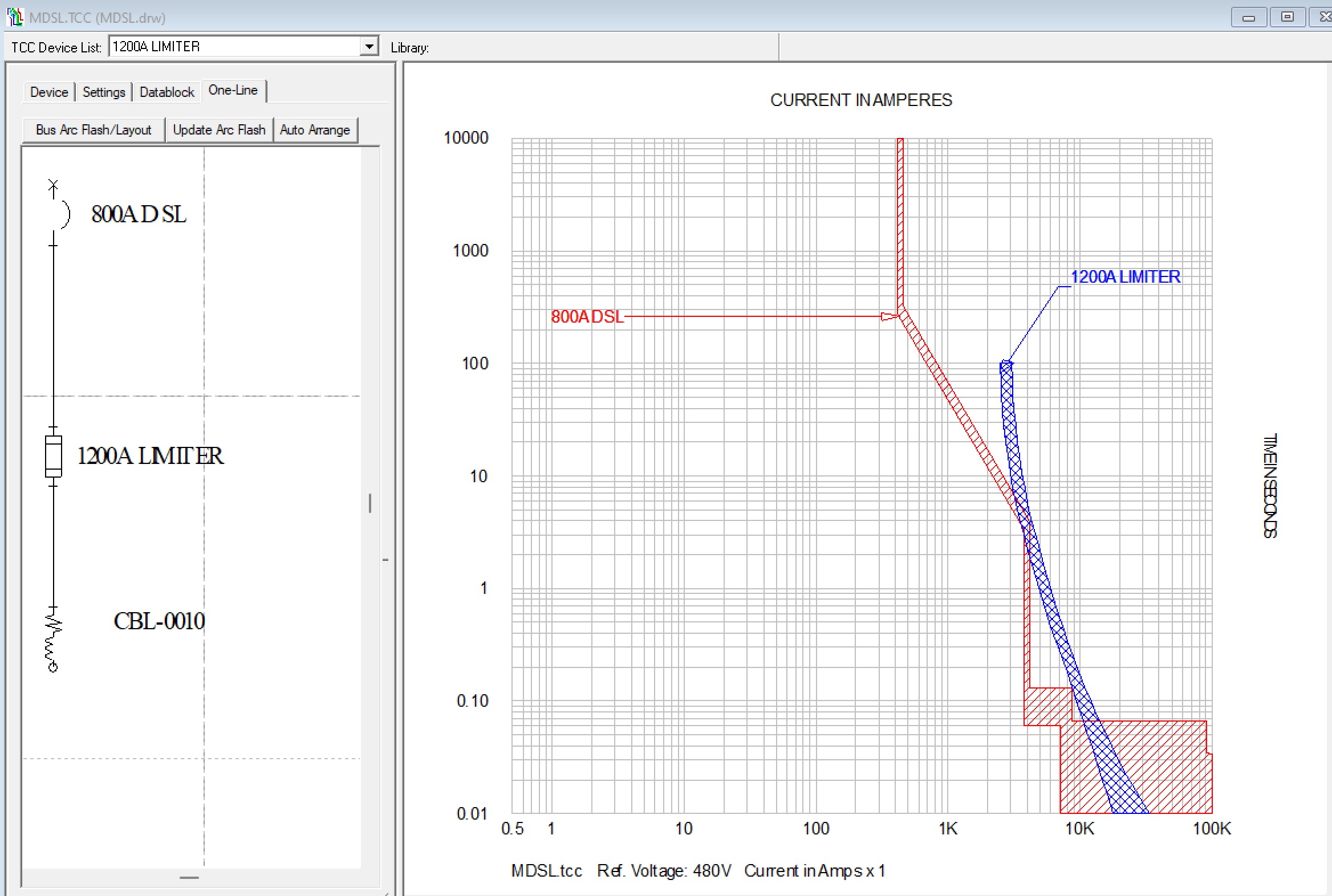

Looks like you have an Eaton Magnum DS with current limiters. Just put the breaker and current limiting fuses in series with each other. Here is an example but I don't know exactly which breaker you have or what the amp rating is of the limiter so I just somewhat randomly picked them. This is in SKM.

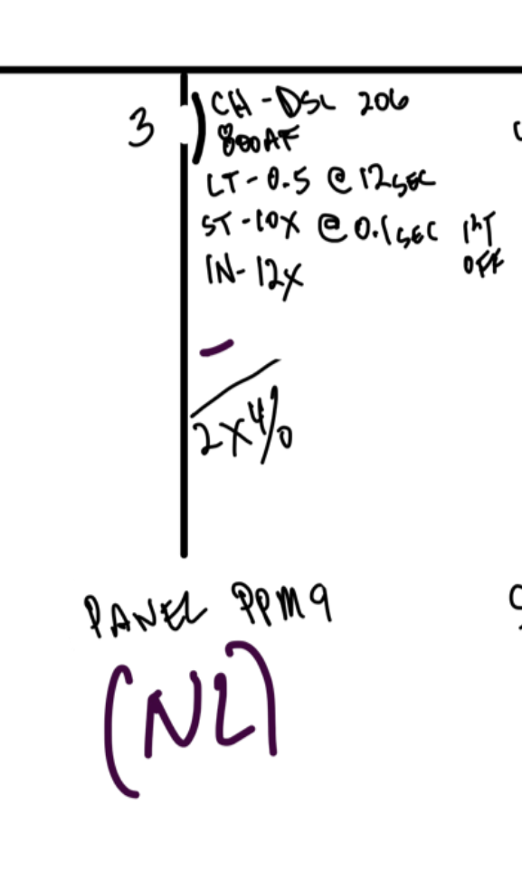

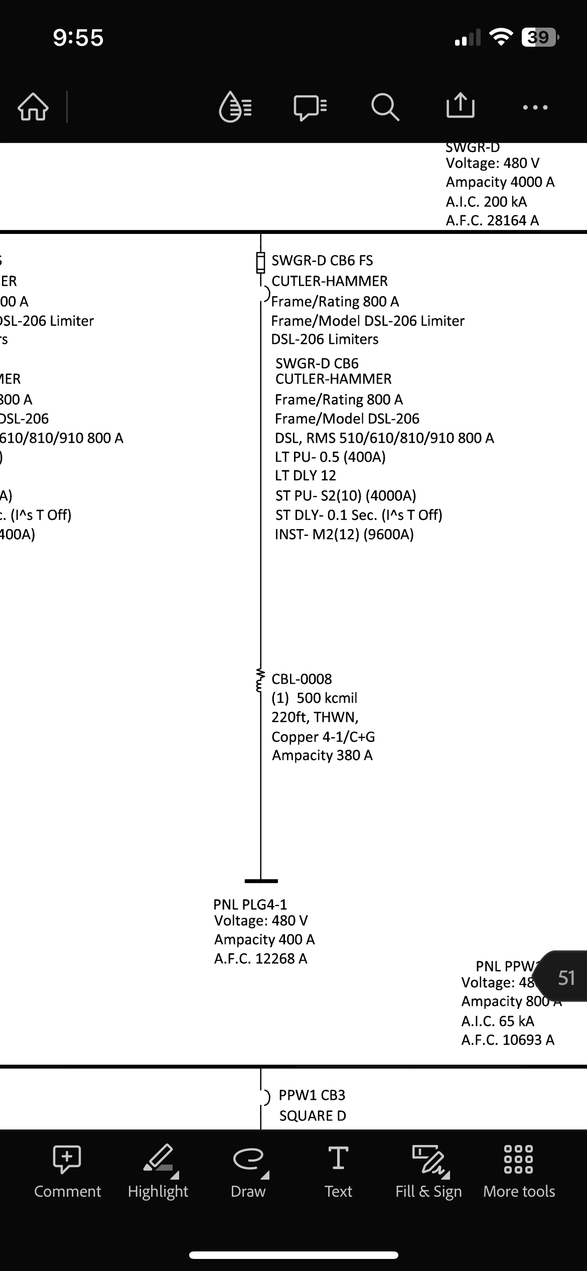

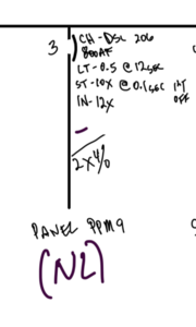

Man, I think I have modeled it incorrectly. I thought it was fuse then breaker.
File comment: Another example for cb 6
File comment: It's cb 6, 7, & the main circuit breaker.

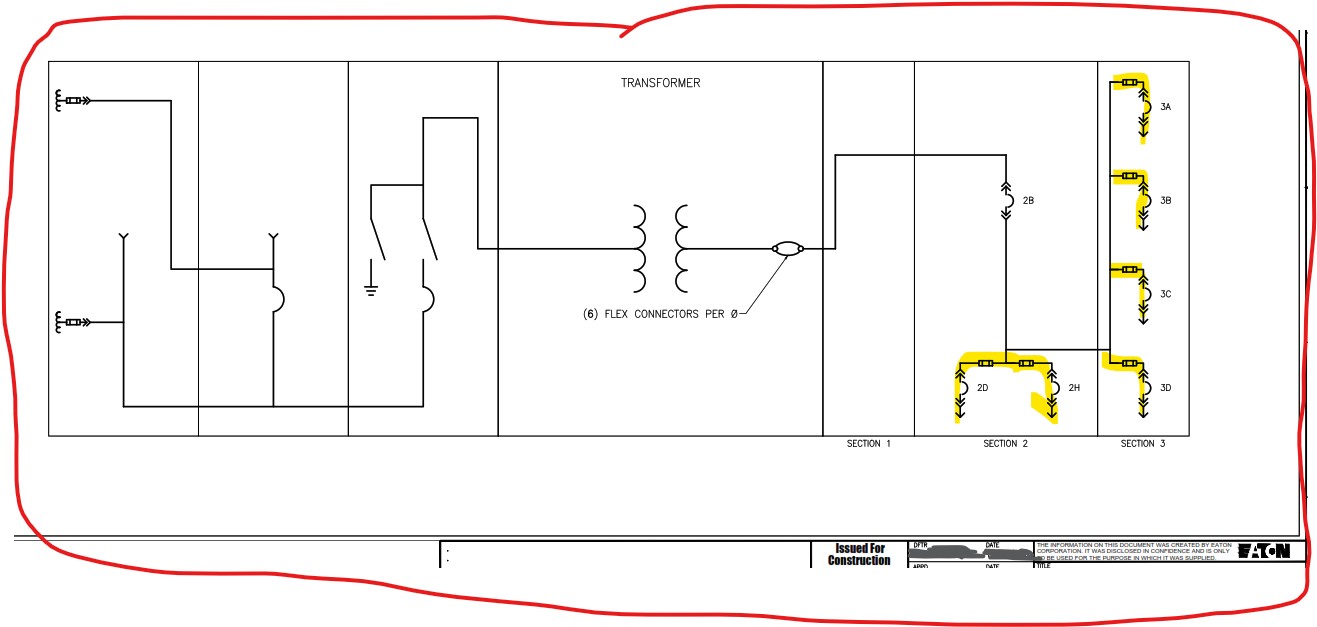

Looks like you probably are correct fuse then breaker if I'm seeing this pic correctly.

Bus then limiter then breaker according to some old shops I had. You were correct:
