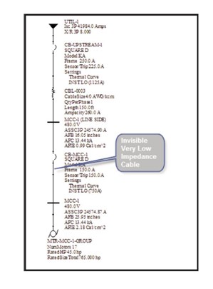

Does anyone know how to model this Low Impedance Cable? I am trying to show the line side and the load side of a Switchboard on SKM. I found this page.
https://www.skm.com/SKM_Arc_Flash_Line_ ... 0Side.html

I would select a large cable (e.g. 500 kcmil or larger), make cable length minimum (0.1 feet I think is SKMs minimum length), and add multiple cables in parallel. I believe the reporting option 'Report line side and load side' may provide the results that you are looking for without the need for this cable. As far as making the cable symbol different than other cable symbols, I haven't investigated how to do that - I just label the cable as a DUMMY_CABLE and move on.
