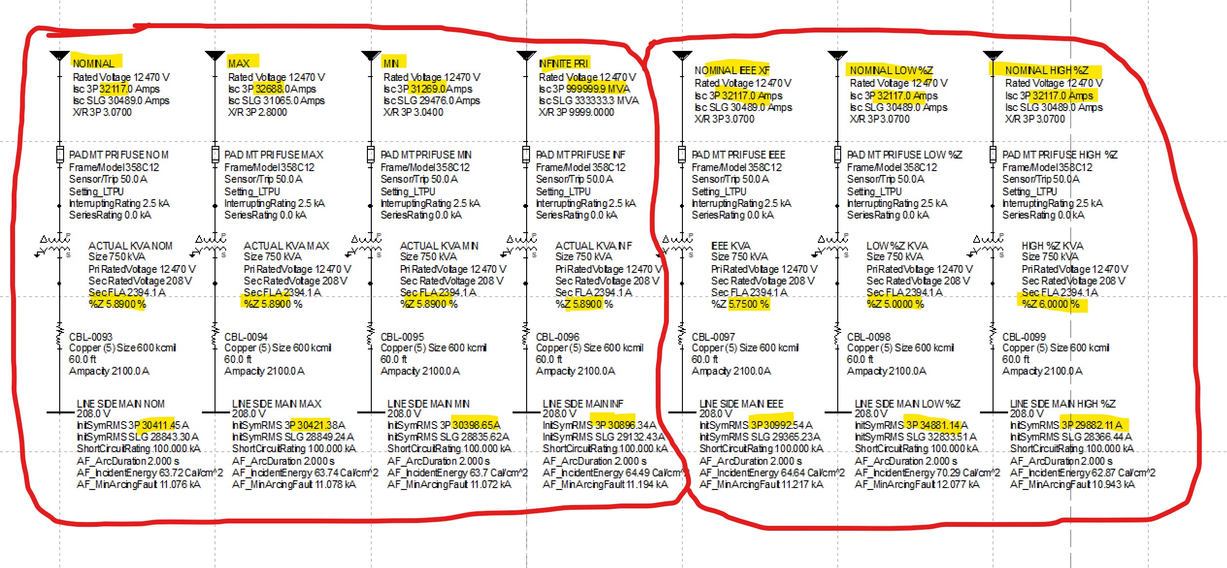

The local utilities vary a bit in how much info they provide on request. Sometimes they'll include everything upstream of the utility transformer all the way down to the AFC at the service meters, sometimes it's incoming AFC only, and I've seen everything in between. Sometimes they're also not interested in giving me more than they provide initially.
With that established, how do you go about modeling equipment upstream of the point of demarcation when utility info is limited? Is getting the correct AFC at the point of demarcation the most important factor to ensure accurate modeling of the downstream system?
I've previously treated incoming AFC as the crucial element. When the utility has been unable or unwilling to provide additional info, I've usually modeled a dummy utility and utility transformer and tweaked the impedance on the transformer to get the correct AFC at the demarcation point...but I want to make sure I'm not doing something that may introduce inaccuracies in the way the software (EasyPower) does its calculations. Thoughts?

I'm also interested in the question of "is AFC enough info to do accurate modeling?" to help me understand the modeling process better. Assuming the AFC provided is accurate, is that enough info to create an accurate model downstream?
I don't recall if I included this in that video or some other avideo or just shared it with a viewer via email, but transformer impedance has a larger effect on secondary available fault current than the primary AFC and is less likely to change. It's easy enough to prove this to yourself. Set up 9, 1000 kva transformers. Infinite primary, 10,000 amps primary and, say 2000 amps primary with 6%, 5.5% and 5%. I expect you'll find that impedance has the greater effect. By a lot.
Utility nominal, max and min primary amps that only differ by a couple thousand amos on at the primary is basically negligible at the secondary compared to say, a 0.5% difference in %Z.

I found the example I was referring to earlier. Not exactly the parameters I described in the experiment, but the message is the same. The primary Nominal / Max / Min are straight from a utility company actual job as is the 5.89 %Z. You can see that only makes a few hundred amps difference on the secondary, even going to infinite bus on the primary.
The example of changing the %Z on the transformer makes 5,000 amps of difference. I think it is more important to get the actual %Z than the actual primary AFC, but both are still important. If you are doing a new design and want to make sure your equipment has adequate interrupting and/or withstand ratings I highly recommend using infinite bus primary and a low %Z. For arc flash purposes, I recommend being as accurate as possible for as-built conditions.
