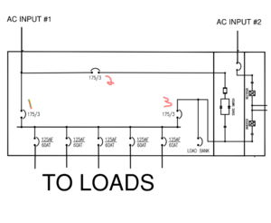

Any tips on how to model this UPS? Ive been searching high and low, but cant figure out the best way for short circuit and AF calculations.

For SS/AF calc's: i only model the UPS static bypass, since during a fault condition, it will transfer to bypass any way and deliver the full fault current the system has available to the fault.

Fully Agree.
