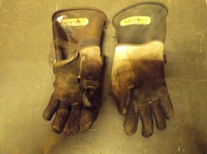

Attached is a pair of rubber gloves that were exposed to an arc flash. Does anyone have a feel for the incident energy level they may have been exposed to?

From the modeling done, it looks to be about 53 cal/cm2 exposure. It was in a self contained 208V meter socket. The event was described as:
Meter tech had installed jumpers in a meter enclosure to remove and replace the 208V meter. In the process of removing the meter an arc flash occurred and sustained until cleared by a substation breaker. The riser fuse did not operate.
It was determined that the arc occurred in the conduit between the race and top mount of the meter enclosure. It was described as a sustained open air arc in the conduit between a conductor and the conduit inner wall.
Still evaluating so probably more to come........

Received more explaination of what happened:
The fault started out in a self-contained meter can 200 amp phase A to ground high impedance eventually burned into another phase conductor B making it a low impedance so it cleared one secondary fuse now it’s back to a high impedance fault one phase B to ground until it burns into another phase C conductor making it a low impedance clears another fuse so we are down to one fuse phase C which DOES not blow because it’s a high impedance fault.
Fault cleared by opening substation 12.5kV bkr
