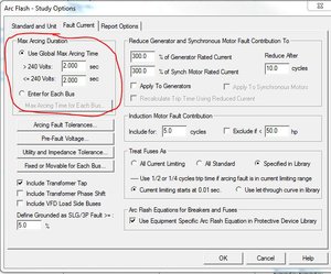

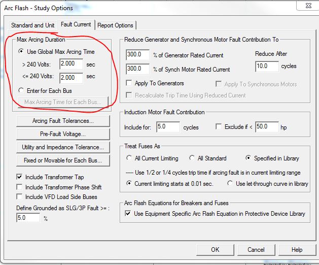

Sorry I can't help you but 200?
Are you using the "2 second rule" and still that high?
Yes, 200.3 cal/cm2 to be exact and with the 2 second rule. These values are seen at the low-voltage switchgear which is directly connected to the secondary of the transformer. Luckily, in this case we just replaced the switchgear and all buckets have ARMS. With ARMS activated I can get the IE down to 4 cal/cm2 for all feeder buckets.
