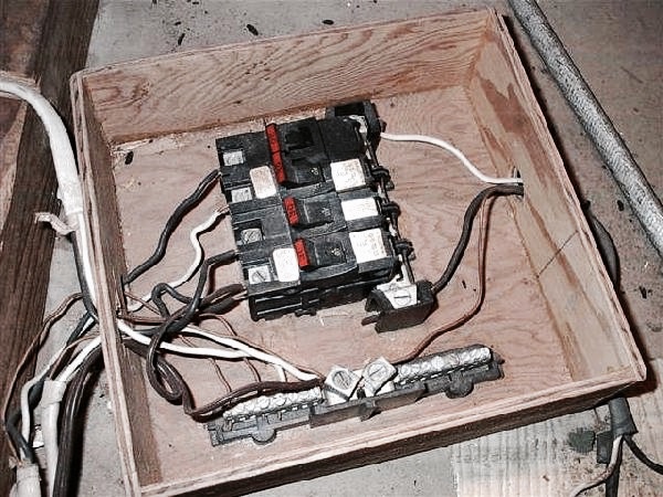

 Post subject: Wooden cabinet and panelboard in attic
PostPosted: Tue Mar 12, 2019 4:26 am
Connected to service cable in an attic to get free electricity!
File comment: In the attic free electricity.

at least they used a circuit breaker...

So now “enclosures� need a terminate inspection?
 Post subject: Re: Wooden cabinet and panelboard in attic
PostPosted: Sat Mar 23, 2019 2:55 am
Yes,� Jim, the cable here was tapped to the drip loop and was run into this attic so that electricity could be stolen by tenants!
