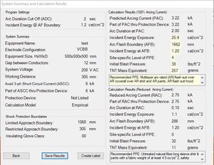

(images snipped)
With terminal short circuit current of 15625 amp.
The short circuit current 20 feet away AWG 1 is much lower 11595 amp.
Why is it much lower?
Did the arc flash method somehow give the 20 feet conductor an inductive value, but it's not part of the transformer winding.

Is it possible the official arc flash current fault calculation method based on getting the constant c and solving for f and Isc is just wrong?
Maybe Jim Phillips has developed his own formulas different from the faulty official ones?
The short circuit current in the official method at 20 feet away (AWG 1) wire is 25% less while in direct logic based computations, it is only 1%. In fact an electrical engineer not familiar with arc flash calculations told me it was only 1% (he was the one who taught me how to compute manually) and he couldn't understand why the arc flash method becomes 25%.
I'm not asking for detail computations of loads, etc. I just want to know the fault current 20 feet away of service conductor (AWG 1) given any transformer source Isc. For my particular case, I have already computed the Isc of the transformers with help from an EE.
My building is only office load, so no need for motors, and all those miscellaneous equipments available in large commercial settings. Also I live in the Philippines so can't attend Jim classes in the USA as much as I want to.
So my questions are only limited to the previous message why the offical formulas based on getting constant C and solving for f and M and Isc gives too low short circuit current after 20 feet of service conductors.

On second thought. I won't cut it anymore. Last night before I slept. I tried a free software that can only register up to 208v. I hope the creator of this web site can create one too. I entered 2 secs and the incident energy at 305mm away is 25.9cal/cm2 and arch flash boundary is 1.662 meters (1.2cal/cm2). It horrified me (see attachment).
Also I read "Investigation of Factors Affecting the Sustainability of Arcs Below 250 V
Michael J. Lang, Member, IEEE, and Kenneth Jones, Member, IEEE"
"The testing discussed in this paper shows that sustained arcs are possible at 208 V even at relatively low fault currents but are dependent on several factors including voltage variations, conductor material, the configuration of conductors, and the presence of insulating barriers. The challenge to industry is to advance the research identified in the references, do additional testing on a variety of low-voltage equipment, and incorporate those findings into improved standards. These test strategies must consider all practical locations within the equipment where arcs may occur; within all equipment is the possibility for different electrode orientations."
And I read "Effect of Insulating Barriers in Arc Flash Testing Robert Wilkins, Member, IEEE, Mike Lang, Member, IEEE, and Malcolm Allison, Member, IEEE "
"With an insulating barrier arc lengths and voltages are lower, the arcing currents are higher, and the maximum energy density, which is found on the middle calorimeter, is much higher than the one measured with the standard IEEE 1584 setup. Self sustaining arcs can also be produced at 208 V with relatively low levels of bolted-fault current."
I hope IEEE can create experiment where the 208v 6kA 12mm gap can be sustained for 10 secs. I want to see if it would equal the incident energy of major high voltage switchgear meters away.
Whatever, I guess I need to get Oberon ballistic PPE suit. Our PPE is only based on thermal and not adequate.
