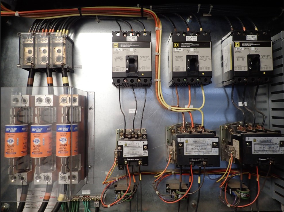

I've mentioned this particular case on here a few times. I finally got permission to obtain and share photos and videos so I made a video about it on my YouTube channel. I hope it inspires some discussion. Here is the link:

Thanks Mike.
I'm glad I was able to share the experience. I think there needs to be a different approach to control panels but I'm not sure what it would be. It could be too that this particular case is me just cherry picking something that would likely never happen again and the formulas are just fine. I don't think so however. As I mentioned in the video, there are just too many variables inside a control panel to account for.
A side note, I have noticed that oftentimes control panels will have Class J fuses at their input terminals. I don't know if that is mostly to get a higher withstand rating for the panel or to reduce incident energy or both. For example:

PostPosted: Tue Apr 01, 2025 12:00 pm
I have never cared for calculating AFIE at different points within a control cabinet, unless it is very large with multiple doors. In my opinion this is similar to not calculating AFIE at multiple points within a circuit breaker panel or switchboard. There are too many variables to consider as far as the arc propagation.
My experience has been, current limiting fuses are used in control panels to comply with the SCCR procedures in UL 508A.The fact these fuses could have a possible benefit for AFIE is purely coincidental. The majority of customers have wanted the panels labeled with the arc values at the incoming lugs.
There have been a few times, like multi-section drive cabinets where we did calculate AFIE on the line and load sides of the main switch.

JBD wrote:
I have never cared for calculating AFIE at different points within a control cabinet, unless it is very large with multiple doors. In my opinion this is similar to not calculating AFIE at multiple points within a circuit breaker panel or switchboard. There are too many variables to consider as far as the arc propagation...
I agree. Not only that, I don't think you can. At least not accurately. I don't know that IEEE did any of that type of testing and developed the formulas based on that. Most the videos I've seen of their tests basically involved installing a small gauge jumper wire or in a few instances a common tool across phases at the line side and turned it on.
