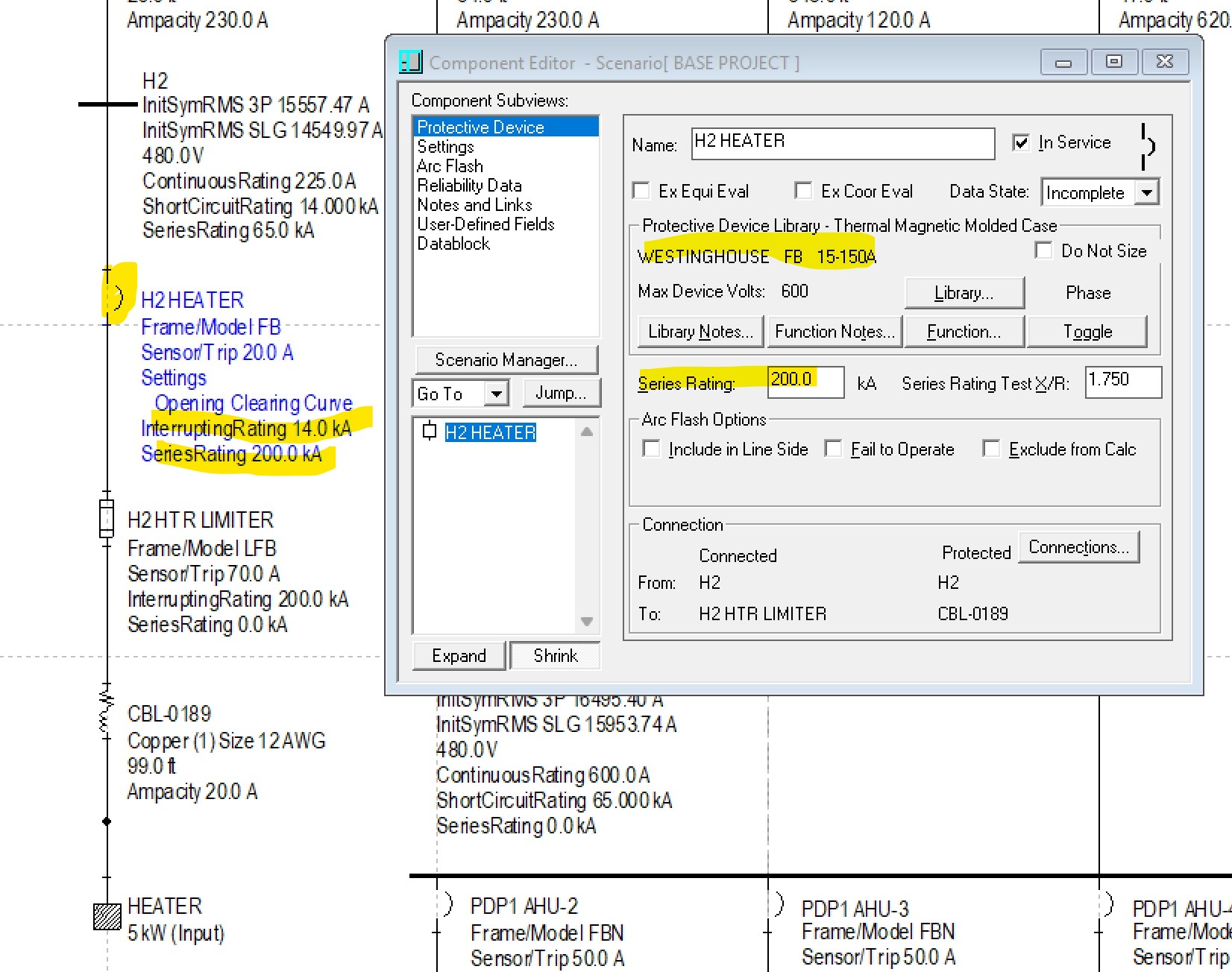

This may be better suited for the Software discussion; if so, let me know:
I'm trying to model a Westinghouse Current Limiter LFB3070R. It attaches onto the load side of an old Westinghouse breaker, and presumably lowers the current. The device doesn't seem to show up in the library of my software (EasyPower), and I can't find any info online about how it works.
I was going to ignore it since it's a (480V, 3 phase) 20a breaker feeding a small heater....but of course, the breaker is only rated for 14kA and the AFC is higher than that. I'm assuming/hoping the current limiter will keep the AFC down to acceptable levels, but since I can't find any info on how the thing works, I'm not sure how to model it. Any ideas?

As Stevenal points out the 14k FB breaker has a series rating of 200k when used with the limiter so you're good there. As far as ignoring it goes, this goes back to your earlier thread about how far do you take it. Unless the heater had a control panel or a disconnect switch that you needed or wanted to label, I would ignore it if I were modeling. A heater has no fault contribution and if no label is required then no reason for me to include it.
RE: Modeling, I cannot help you with EasyPower but here is how I would model it in SKM if I needed to. The limiter is in the SKM fuse library and looking at the device online it looks like it is a one-and-done fuse module that needs to be replace if it blows.

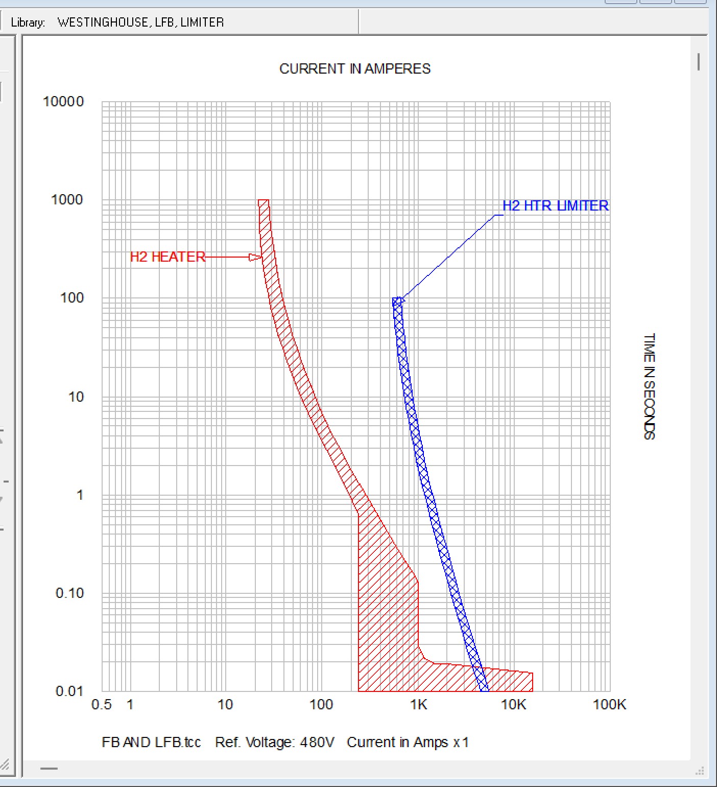

And the curves:
Ah, thanks guys! In all the research I did, I didn't see the word "fuse" or "element" mentioned anywhere....but it makes sense to treat it that way, since it's good for one use only. And sure enough, while EasyPower doesn't have the Westinghouse Current Limiter in its library, it does include the Cutler-Hammer version. Much appreciated!
