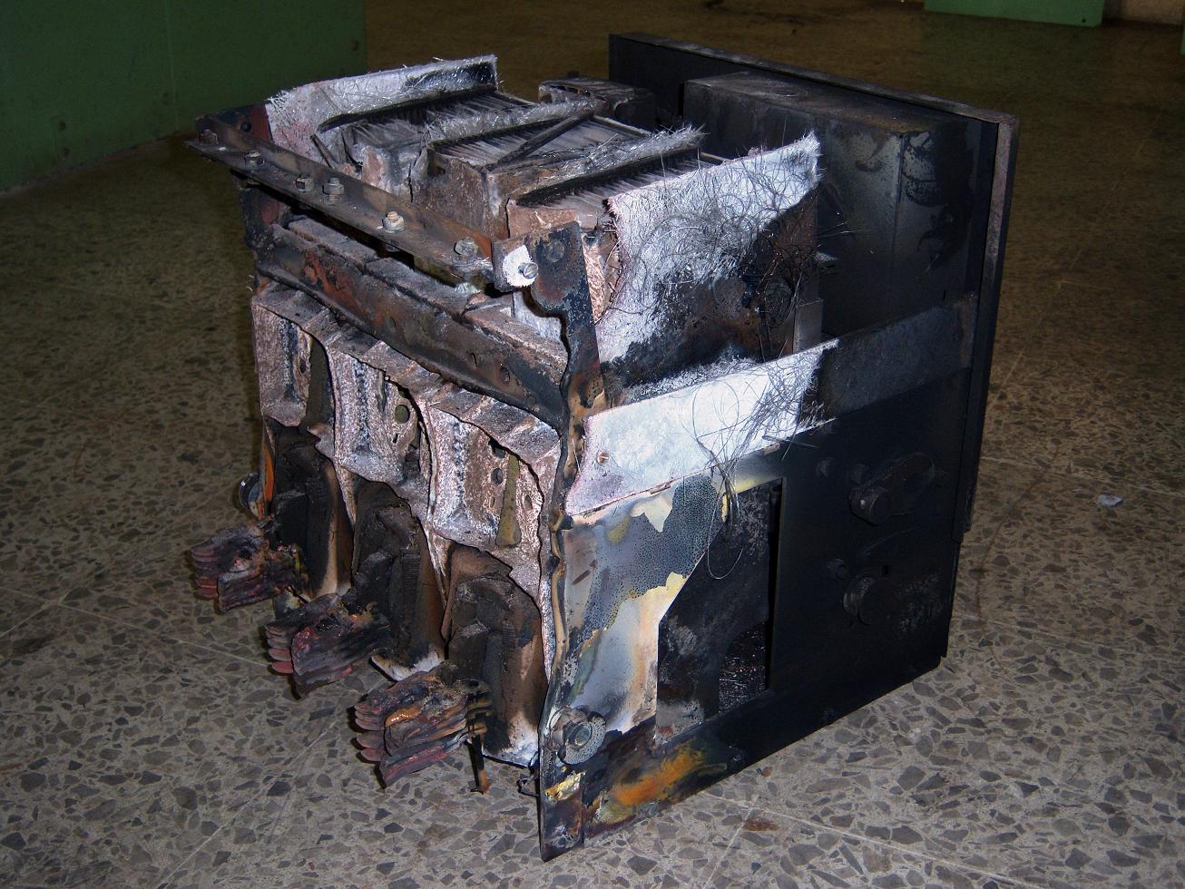

toolbbin wrote:
one piece cape type ppe rated for the task.
Long coat designs are protection concerns. For more information please see attached....
Available Fault Current on AF Calculations - IEEE.pdf [1.01 MiB]
Downloaded 466 times
