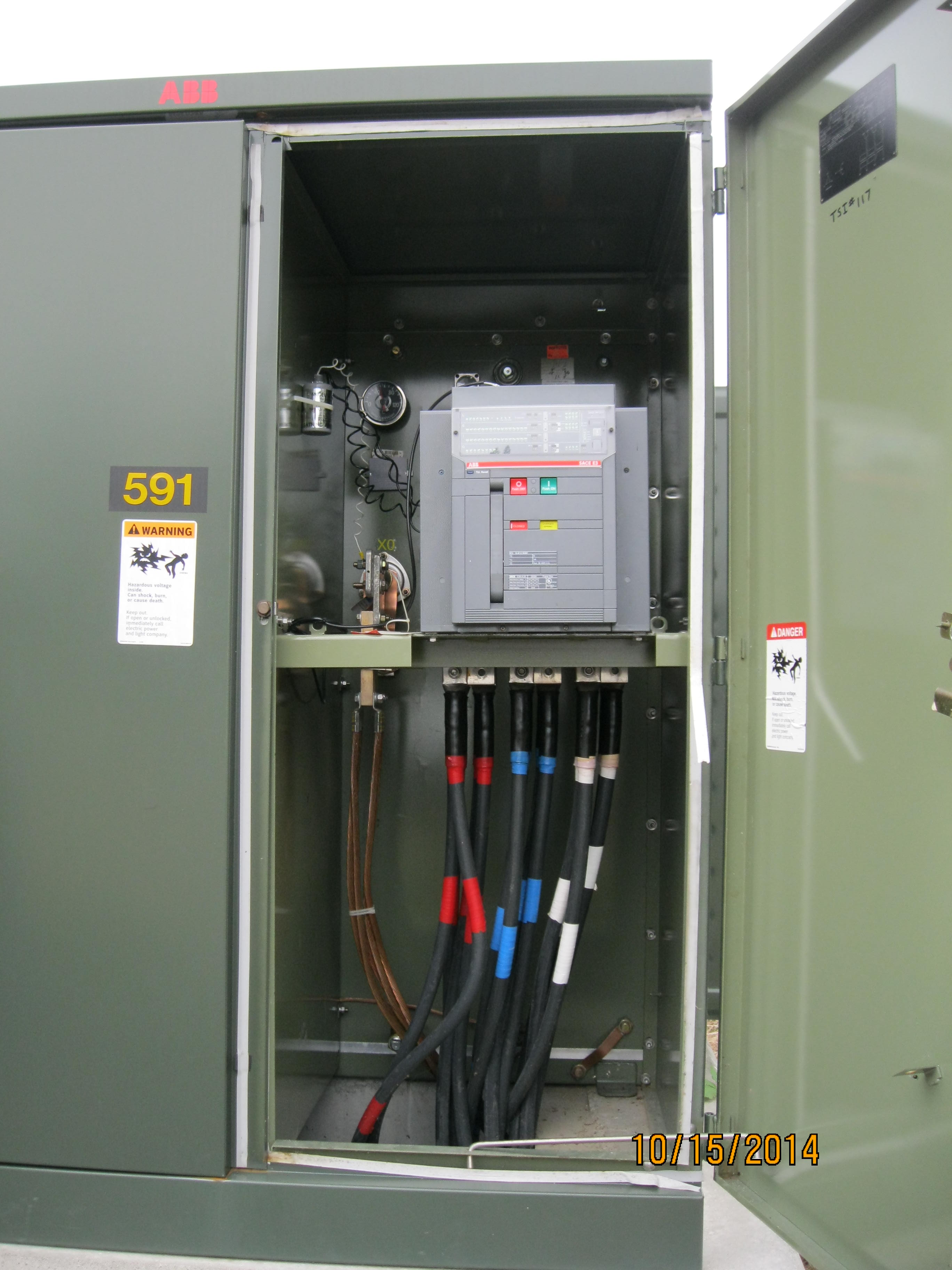

Hi All.
I know I've seen a picture or two of your typical oil filled pad mounted transformer that had fuses or a breaker installed right off the paddles on the secondary compartment. I tried googling it and could not find any.
I've asked our ABB and Cooper reps if they offer and factory installed breakers or fuses and they both said "no".
Has anyone come across anything like this? I realize on the bigger sizes it may be very difficult to do and be able to get several sets of parallel 500's landed due to limited room but there would be some instances where it could be an advantage to "move the problem" from the line side of the switchboard main out to the transformer.
Thanks.

Maybe this is what I saw?

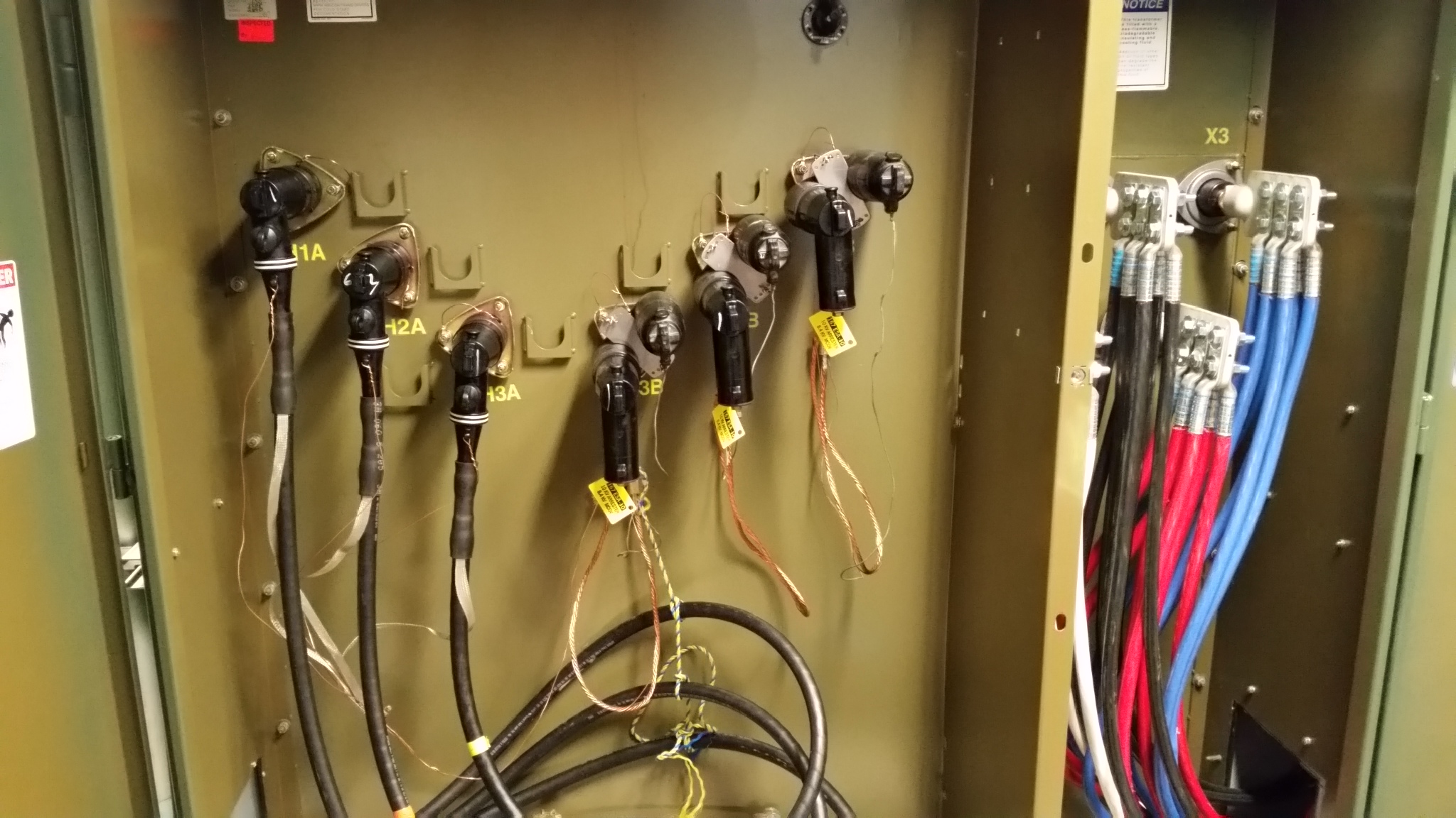

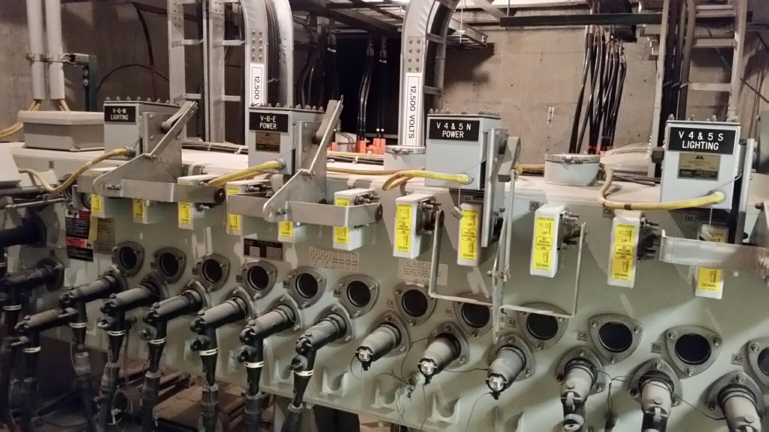

Yes, I'm familiar with all of the above types of primary side fused protection.
The reason I am asking in the first place is that last week we energized a new 500 kva transformer with primary side bay-o-net fuses AND a programmable VFI on the feeder to the transformer. One of the secondary feeder conductors was nicked and in contact with the secondary cabinet so fireworks ensued upon closing the switch. The primary fuses did not blow nor did the VFI trip. It took a good 5 seconds to re-open the switch. This is a remotely operated SF 6 switch. If we had a secondary side breaker it could have had settings making it more likely to trip.
This is in a vault. I closed the vault door and stood outside prior to energizing. I could hear multiple explosions and see multiple flashes under the door during the event. I expect the actual amount of fault current was fairly low as I can see the fault path through the cabinet at each bolt (the cabinet is bolted on to the transformer tank.) I will upload some pics. NOTE: There was rubber or vinyl trim molding around the cutout in the side of this transformer cabinet and the wireway that was bolted to it. Not sure what happened. It must of come off to some extent while pulling in the secondary conductors.

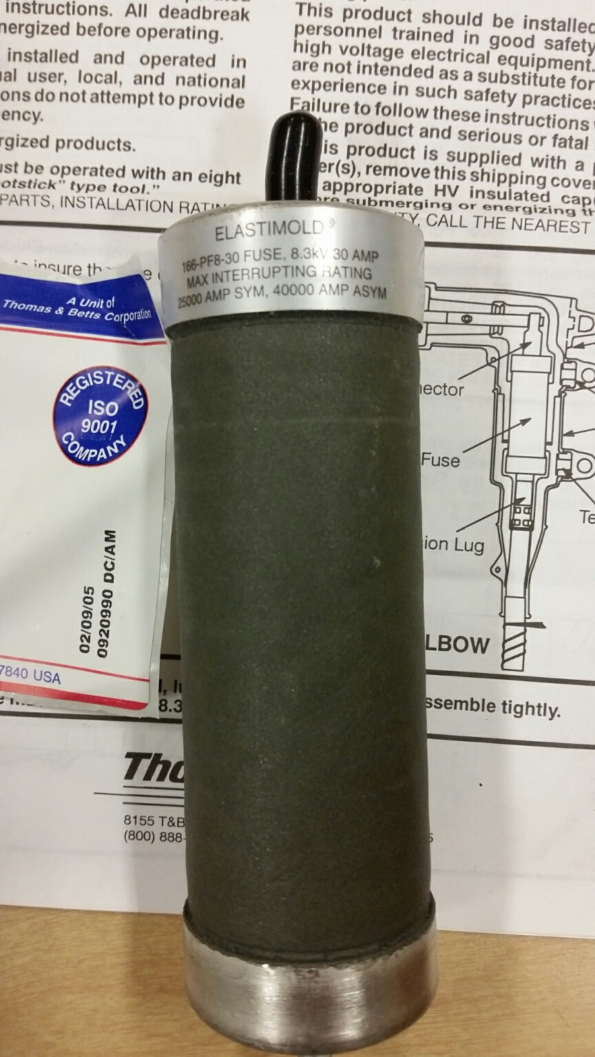

Oh, we have a few fused elbows around here too. Plus some old Joslyn fuses you plug on to the 200 bushings then plug a regular 200A loadbreak elbow on to. They don't make that type anymore but we still have several in service. Fortunately we have a good stock of spare on hand. See pics of both types I just happen to have on hand.
