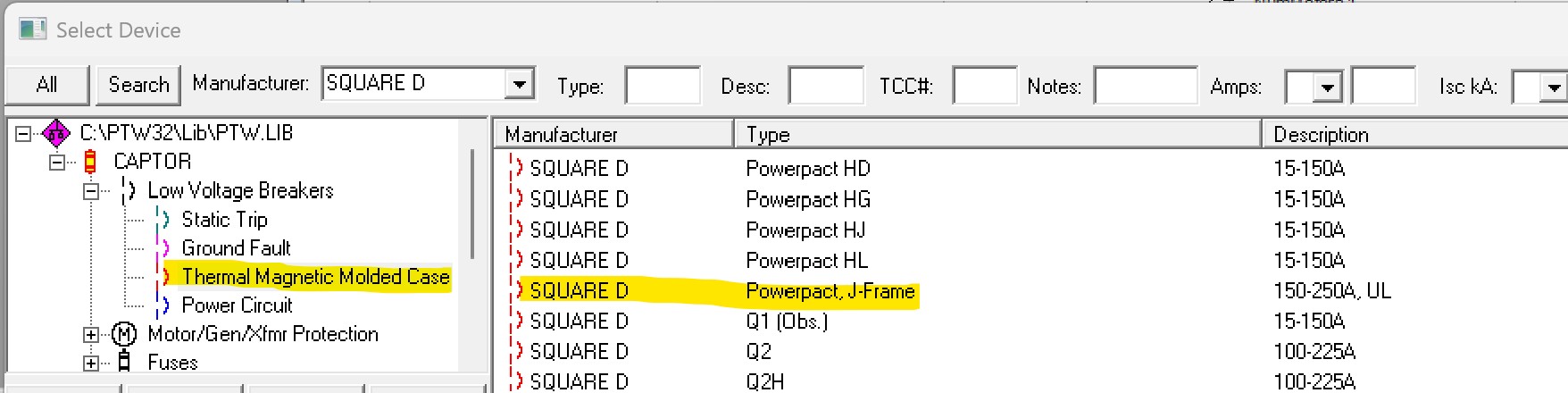

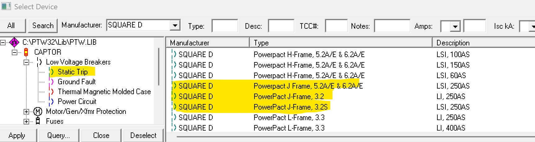

Here is what I was trying to explain. Both are J-Frame PowerPact but in different folders as one is Electronic Trip and on is Thermal Mag. It is easy to be looking in the wrong place in SKM. Easy Power may or may not be similar. Just don't know:
