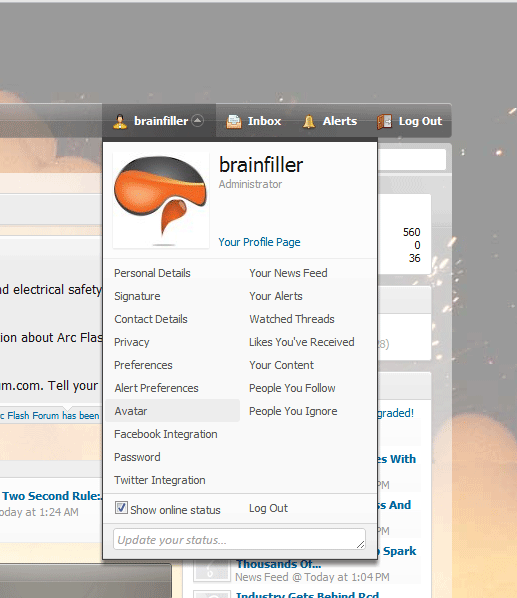

Here's an interesting phenomenon that results in huge IEs. See the TCC on the attached PDF.
The red curve is for a SEL 351 on the 115kV side of transformer T46. The predicted arcing fault current on T46's 7.2kV secondary is 21.7kA. Note that the 21.7kA line is to the left of the end of the SEL curve data and to the right of the longtime pickup line (short red line at top near R-122 P).
According SKM, the arcing fault 'threaded the needle' of available data for the relay. The program can't find the intersection of the AF amps and the relay TOC curve. The IE result is limited by the maximum arcing time.
We actually had a 'squirrel incident' at that location, which resulted in an arcing current of 39kA and did eventually trip the relay in about 3 seconds.
