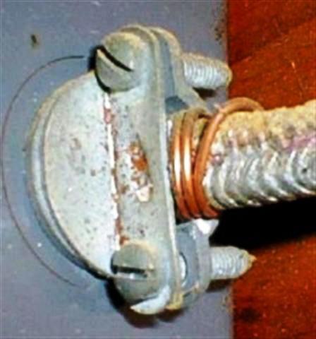

This method was used to provide for a termination of the equipment grounding conductor in this type of cable assembly.
Sure its wrong. how did your area call this out? :cry:
File comment: Boston Back Wrap?

Please tell me about this reply and how it helped you. It is not a recognized method.
