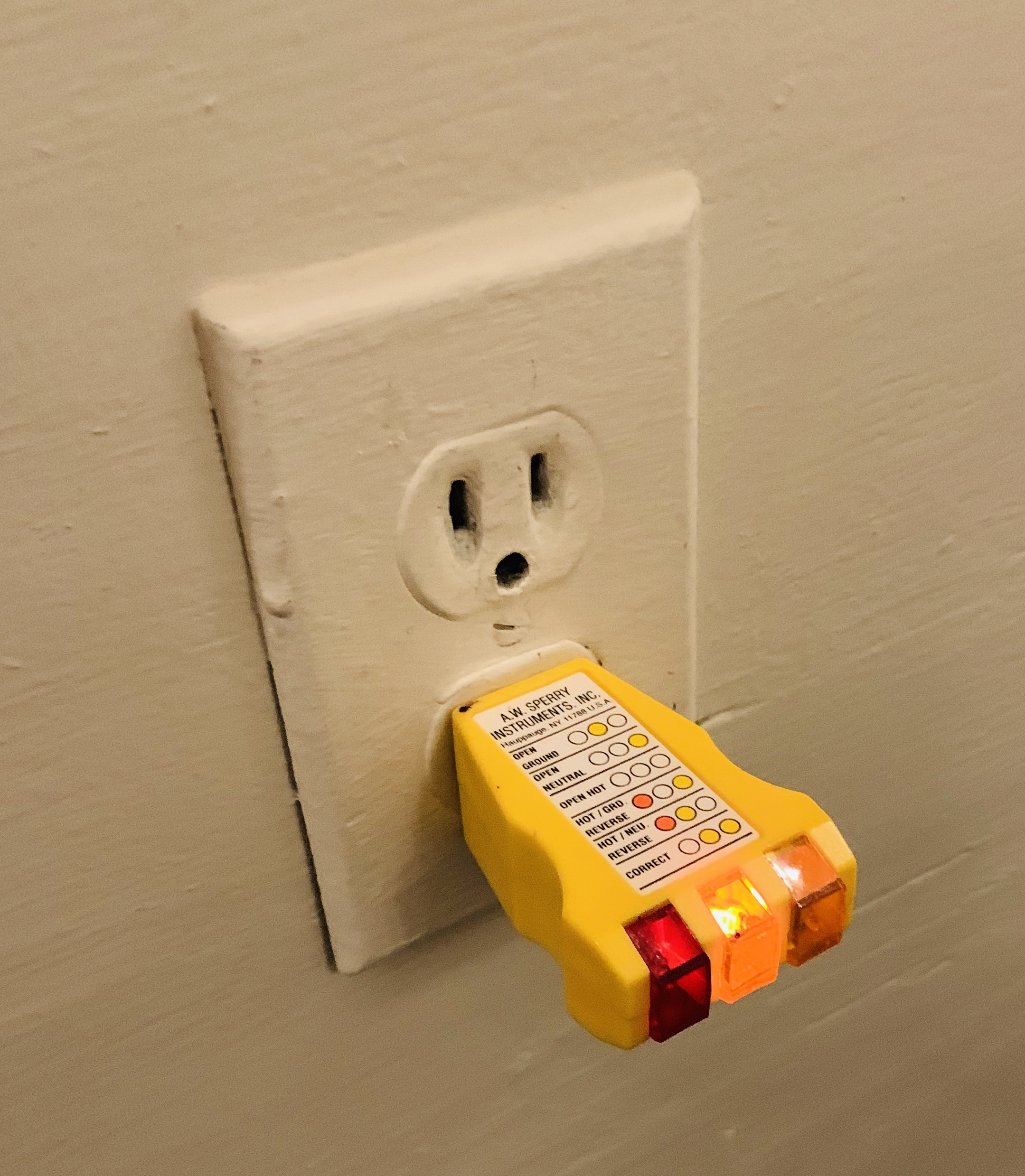

Using this type of device to check your receptacles will reveal those that may not be properly.
File comment: Open ground
