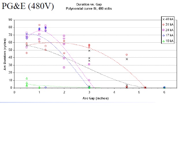

PostPosted: Fri Mar 25, 2011 5:03 am
Posts: 1103
A 120V residential panel is "not likely" either, but here is one that was.

PostPosted: Fri Mar 25, 2011 5:07 am
Posts: 1103
JBD wrote:
I have continuously stated my discussion is about the routine on-off operation not resetting of a circuit breaker rated/listed/tested to be used as a switch.
I don't think I ever said you did not say that. So, as far as labels, do you put different HRC's on your labels for "normal operation" and "reseting"? If the calulated Ei is a HRC 3 like in the OP what method do you use to determine the HRC for "normal operation"?
