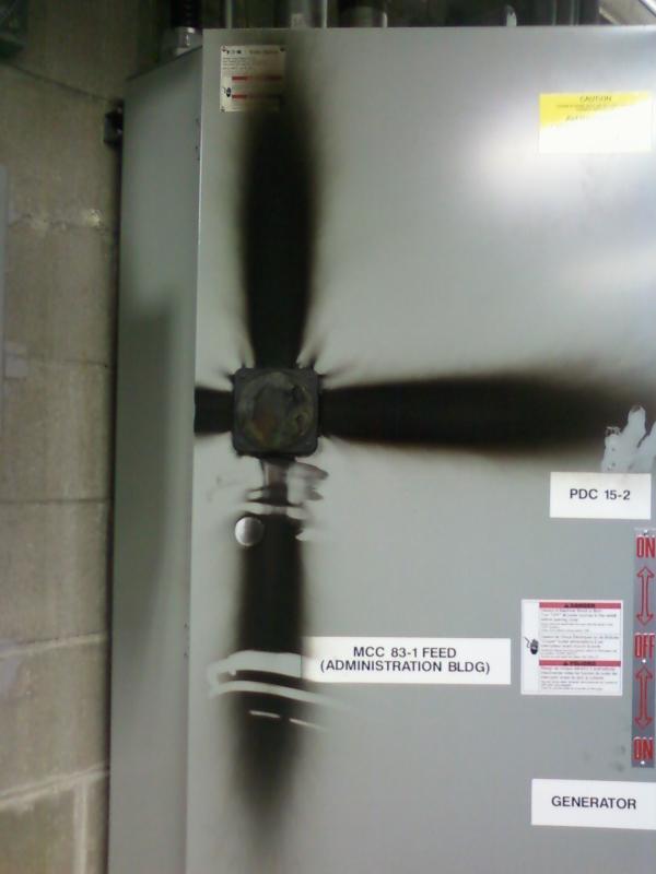

PostPosted: Mon Oct 12, 2009 1:42 pm
Posts: 1103
Closed doors, good solidly built ABB metal clad gear.
PostPosted: Mon Oct 12, 2009 1:44 pm
Posts: 1103
Closed door, 13.8kV switch, only HRC 2 per the tables with doors closed.
I can do this all day, I see this stuff everyday. I don;t care who intreprets what how, or if a FPN is enforceable or not, unless it is arc rated, switchgear can not be relied on to contain an arc flash.
I was sure you could post them all day!....and knew I would get them. :D
But what I want to know is the IE level on the outside of the cabinet and how you would do the calcs. On the one with the cover blown off, was anyone burned or was their head knocked off?
As with WDeanN, I have seen the fire (while I was also movin on), as well as, the results of the events, but we all know many entire flashes are contained by the enclosure. Who takes pictures of them?
I just think it is time for someone to support how an HRC 4 enclosed bus can be determined to be a 4 outside the unit, with doors closed and latched. This has been a major source of heartburn for me since the beginning....or could you already tell. :)
