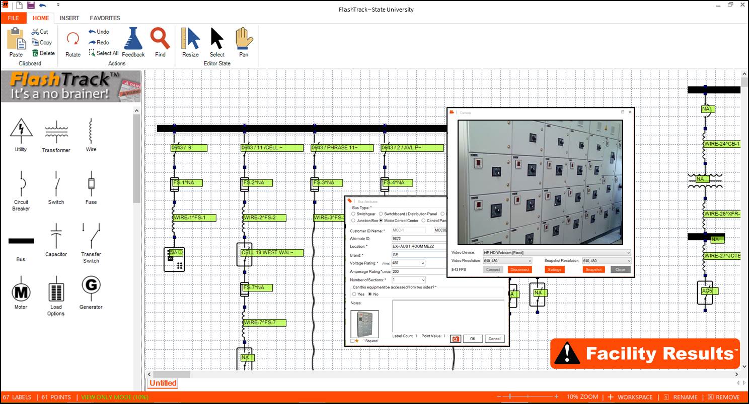

Attached is a simplified diagram of an inverter. I’ve only shown one phase of the output.
There are essentially three voltages that come into play:
The voltage feeding the DC BUS, 1000VDC voltage from a DC source,
The AC output voltage, 315 VAC RMS voltage you measure phase-to-phase,
And the 660 VAC RMS voltage you would measure phase-to-ground.
The output is actually AC riding on DC (like a huge 480-volt, 60 Hz ripple, actually a chopped-up DC voltage.
Now, as far as arc flash goes, would you do the calculations for each voltage and rate the enclosure based on the worst-case?
In the case I am working on, it is going to get a bit complicated as there are panels that access just the DC – those are pretty easy to calculate. There are panels that just access the AC – again, those are pretty easy to calculate. But then there are the majority of panels that are an intermingling of voltages. Some are partially shielded by interior panels, and backplates
