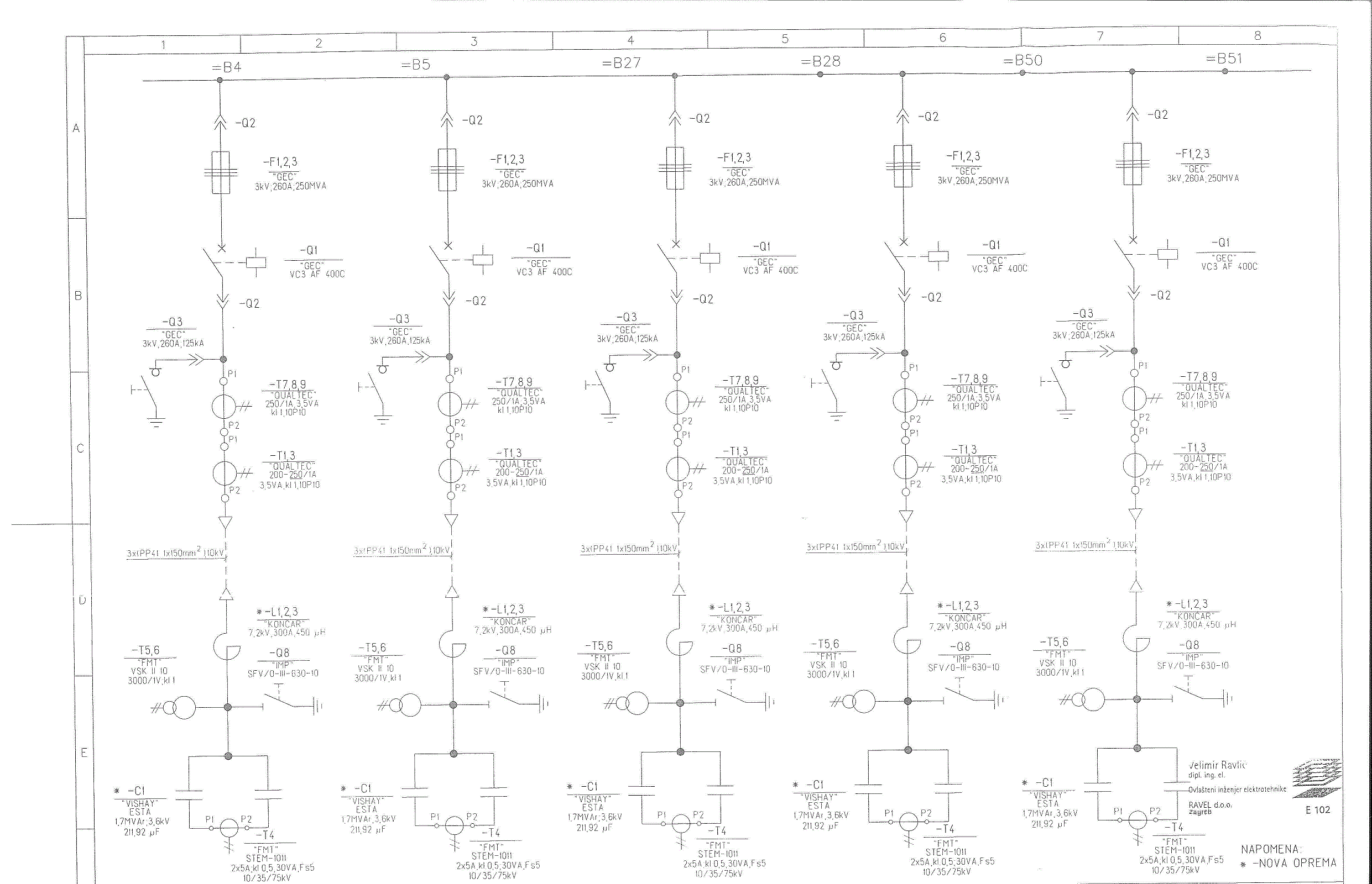

I have a Fire Pump Controller that is directly tapped of the main transformer (1500kVA, 12.47kV-480Y/277V) and as one would expect the arc flash hazard is 63 cal/cm2. This makes is impossible to do any work inside the controller as the circuit breaker is inside the controller. I suspect this may cause some issues in testing and maintaining the fire pump controller and fire suppression system.
I am sure other people have experienced this situation and would appreciate any insight on how you handled it.
Thank you
