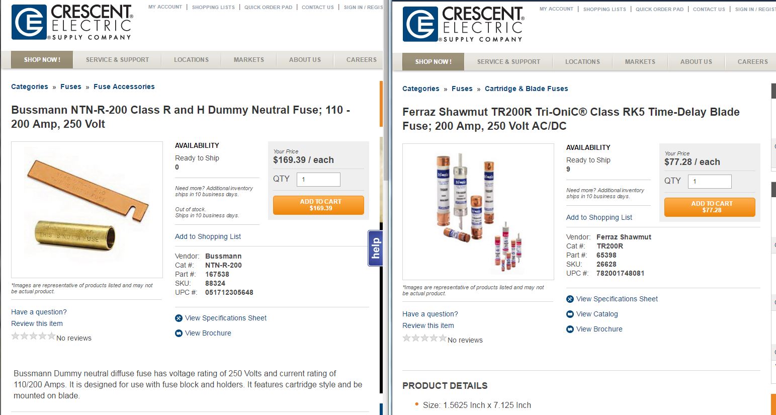

We have a situation where we are installing a 250v/200A fused disconnect downstream of a fused switch (same ratings) to allow for easier control of a panel at the end of the line. I'm wanting to simply use copper bus bar "3/16 x 1" in the disconnect and label it something like "NO OVER CURRENT PROTECTION PROVIDED". Does anyone have concerns/suggestions as to labeling this set up?

Food point about modifying. Using a roll your own slug might be considered a modification as well. Suggest using something made for the purpose. http://www.cooperindustries.com/content/public/en/bussmann/electrical/products/accessories/neutrals_.html

Yep. You could do that or you could just install a fuse:
