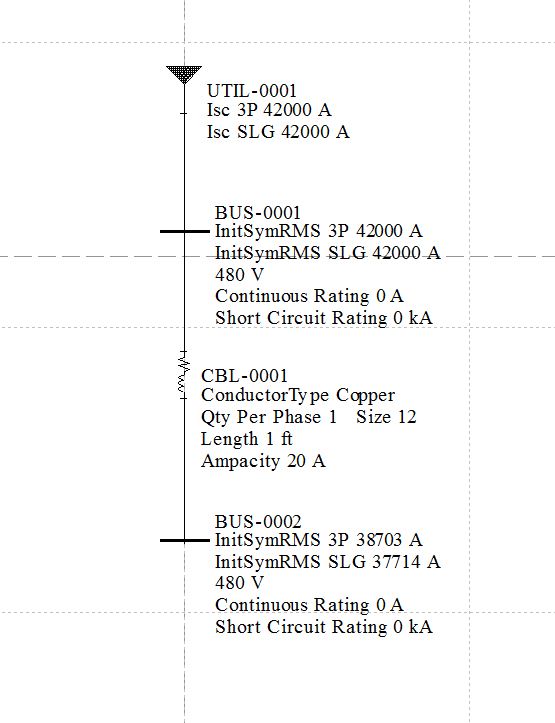

I attended a seminar today and one of the presenters claimed there is typically a significant (well over 40 calorie, even saying 60 or 80 calorie "if you do the calculation") available incident energy amount in an enclosed metering compartment of a low voltage switchboard.
He claimed this was due to the fact the voltage input for the meters are tapped ahead of the main and are therefore unprotected and even though the wire is only #12 or #14 the wire length is so short there is a tremendous amount of fault current.
I scoffed and questioned that logic thinking the withstand rating of #12 or #14 combined with impedence wouldn't allow a sustained arc flash event at all let alone over 40 calories but didn't want to get into it with the guy as it really wasn't the time or place.
Thoughts?

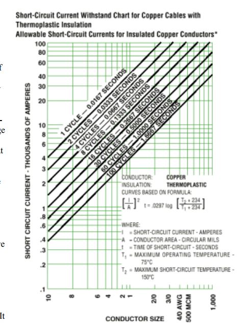

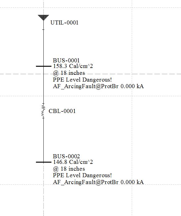

Thanks Paul.
I referenced withstand rating along your same line of thinking, I think.

The equations and curves posted above are for conductor damage. I am unaware of any approved methods for determining the clearing time of a #14 copper wire. Remember also that where arc flash testing is performed, arcs are generally initiated with a fine conductor that completely vaporizes without interrupting the fault.
I disagree with the statement the wire is unprotected since it is ahead of the main. The utility will have protection, even if it's on the primary side with very long clearing times. If this time exceeds two seconds, then cut it off at two seconds per IEEE.
If you are looking at this from the utility side, the NESC has a low voltage table that deals with the IE question. The table is based on testing.
In the arrester example, the utility is likely to have an upstream recloser or reclosing circuit breaker that will give the arc some time to dissipate after the wire separates.
Do not use the method you propose, it is not supportable.

Then the scare tactic consultants need to not propose and throw crap out there like arc blast, arc flash inside low voltage compartments, or the idea that arc flash is "hotter than the sun" with absolutely no supportable evidence either. If there is no supporting evidence (ie, documented cases 2nd degree or more severe injuries in the face/chest region) Garbage in, garbage out.
IEEE does not cover arcs sustained for more than a few inches. At low voltage (under 300 VAC) sustainable arcs have not been demonstrated over more than fractions of an inch even under extreme laboratory circumstances. But we have scare tactic consultants throwing utter unprovable and made up crap everywhere. In fact one of the worst that actually does good work also happens to be the one that put in the revisions for the revised 2018 70E Annex including wild claims about arc flash temperatures and arc blasts. And this is in a peer reviewed standard coming from a so-called expert that is clearly and obviously practicing nothing but scare tactics.
So what is the end user supposed to do when a consultant throws out this kind of bull crap? You can't prove a negative and yet that is precisely and exactly the position that we find ourselves in with these idiot safety consultants that are out there making these kinds of statements.
Don't get me wrong...meter sockets have a proven and very bad track record but there's a big difference between instrumentation compartments and low votlage gear with meter sockets sticking right out of it. EPRI has beautiful pictures explaining exactly what the concern is when it comes to meter sockets as an example.

By my definition, low voltage includes anything at or below 1000V. Bbaumer's figures show he is not below 300, but is operating at 480V. 480 V will sustain an arc easily.
Conductors are not fuses, they were not designed or intended to interrupt faults.
