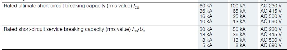

WHICH kA SHOULD I CONSIDER FOR GIVING INPUT DATA TO PROTECTIVE DEVICE IN SKM SOFTWARE FROM FOLLOWING DATA. CLIENT OPERATING VOLTAGE IS 0.433KV BUT IN THE FOLLOWING DATA KA IS NOT THERE FOR 0.433KV OR 433V?

The chart provided looks like a chart for equipment ratings not the available short circuit fault current needed from the utility. Did you request this from the utility?

In the UK 415V transformers are specified as 11000/433 where 433V is the off-load voltage and 415V is the nominal system voltage (Un) therefore you should look for 415V ratings.
Once rated kVA load is applied the transformer impedance will regulation will give 415V on load.
Similar in Aus, although the 415V supply level is now 400V to line up internationally.
The 433V secondary on transformers is common to allow for voltage drop at the end of long cables. Use the 415V ratings in your table.
