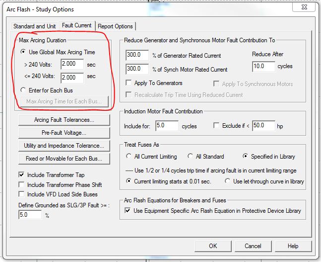

I'm not really sure I understand your question but can offer this. I usually find the worst case scenario / highest incident energy is when the generator is the source due to the lower available fault current and longer clearing time.
Since you say you have no OCP device at the generator or down stream from the generator then your clearing time will be whatever you set your maximum time to be in the software, if any. Generally set at 2 seconds max in my experience for incident energy calcs. A 2 second clearing time will generally skyrocket the incident energy so your thinking that the higher the available fault current and arc fault current the higher the incident energy is not necessarily true. What is worse, 14000 amp arc for .1 seconds or 6000 amp arc for 2 seconds in terms of total energy?

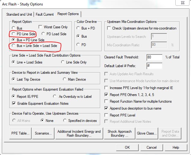

In SKM you can select to calculate incident energy on both sides of a protective device. Not sure if ETAP has that ability or not.
If not, you could try adding a bogus device whose curve is outside the limits so it won't clear and let the 2 second rule kick in. If you can find one.

A couple screen shots from SKM. Maybe you have this in ETAP too?

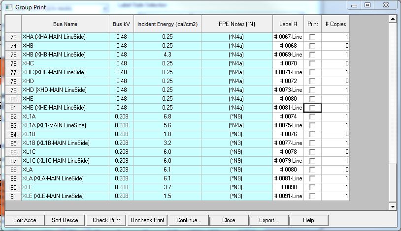

Generally, yes, I select the higher value for the label. If the values are the same I select the line side of the main so the upstream protective device on my label is accurate. Here is a screen shot of a model with several panels that all have main breakers.

You can double click the bus and go to the arc flash tab. Select fixed fault clearing time of 2 seconds (or whatever) and it will calculate IE.
