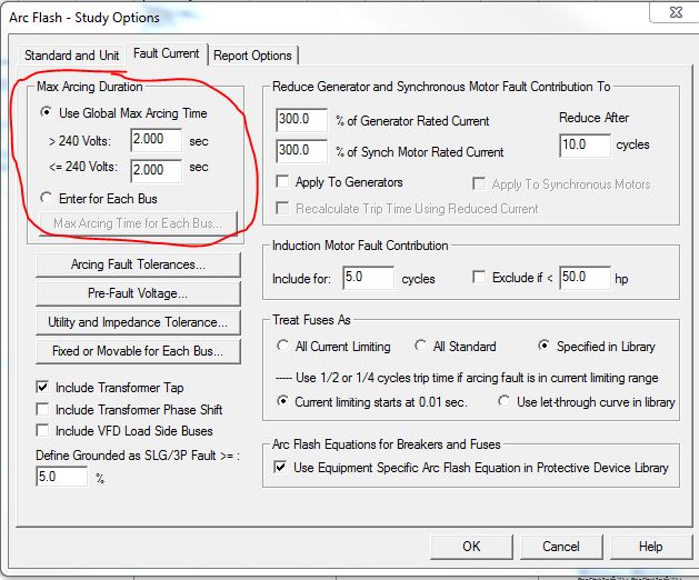

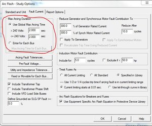

Not sure how to do this in ETAP anymore but again, if you can, change your max event duration or max trip time to 2 seconds. That is what SKM defaults to:

I was able to reduce the max fault clearing to 2 seconds.
I now have an IE of 50 cal/cm2 at the switchboard which is high but at least looks better than 4000.

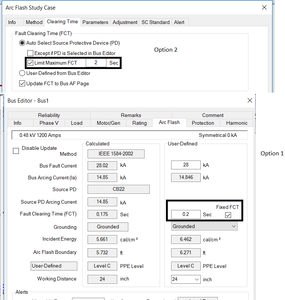

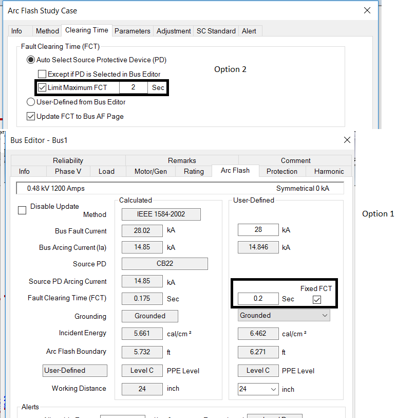

@ bbaumer ETAP does have capabilities to manually enter the Fault Clearing Time (FCT) to any value that is required by using the following options
1 . "Fixed FCT" from the bus editor -> Arc Flash page -> User-defined section
2. Open up the study case -> Clearing Time -> and select the "Limit Maximum FCT" option and enter value of 2 or above.
The first option is meant for individual buses or equipment and the second option is to limit the maximum Fault clearing time by 2 seconds. So For example, If your FCT is 480 seconds for example, with the second option set, the incident energy will be calculated based on the FCT limited to 2 seconds.
