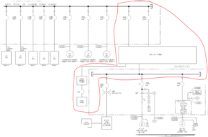

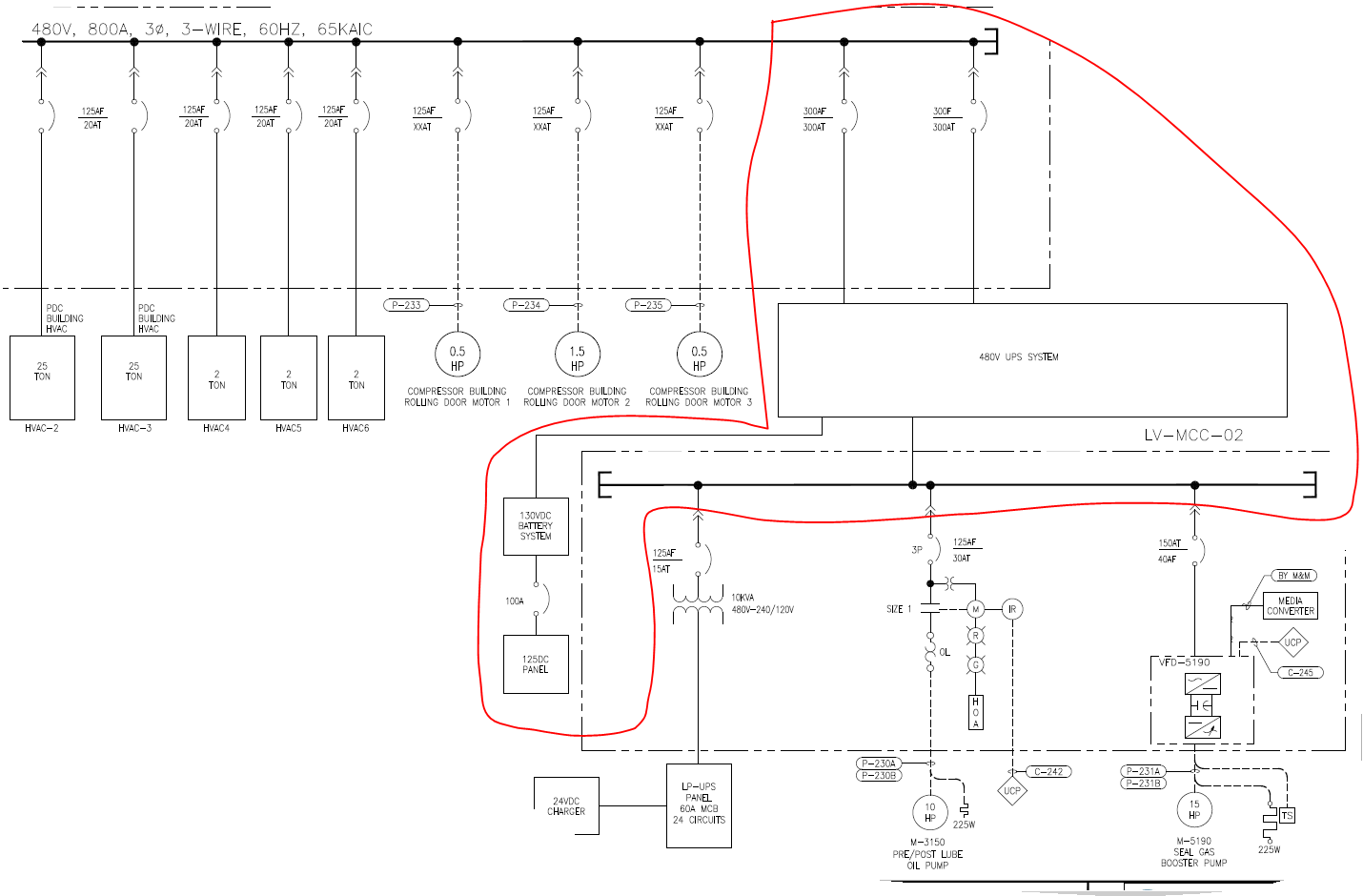

Today I got task with modeling a system in SKM and I'm not sure if I'm interpreting the one line incorrectly or if the one line is incorrect.
1) the 480v UPS SYSTEM is been fed from two separate breakers. I'm guessing it is a double pole breaker?
2) Should I model the 480V UPS SYSTEM as a bus or as a panel?
Has anybody ran into something like that?

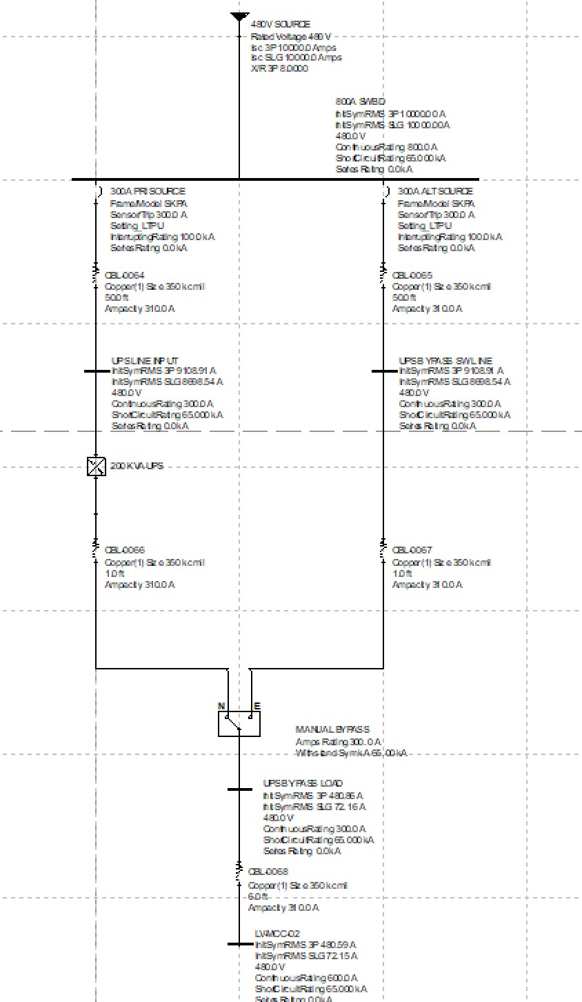

 Post subject: Re: How to model this.....
PostPosted: Thu Aug 01, 2024 2:16 pm
Posts: 497
It looks like whoever designed this distribution system is not really using the UPS as it was intended. The two different feeders to the UPS are intended to be a primary and a backup from a different, in their one-line, a generator, source. They are using two different feeders from the same switchboard which, while better than only one feeder I guess, doesn't really help much if the switchboard loses power.
It also looks like there is an internal static transfer switch to quickly and automatically switch between sources if the primary source is lost as well as a manual bypass switch using a pair of Kirk-key interlocked breakers that bypasses the UPS and puts the load on the alternate source. I can't tell if the bypass is in a separate cabinet but if so, that would allow for you to bypass the UPS and connect the load to the alternate source and completely remove and replace the UPS. Not 100% of that however. It's what the one-line diagram implies though.
The question again becomes, what are your trying to determine? Bolted fault current for withstand ratings only, or an arc flash study for arc flash labeling?
Labeling a UPS is tricky, in my opinion. You can only realistically somewhat accurately label the line side of the UPS, and the bypass switch if it is indeed a separate cabinet, and make it clear on the label that it is line side or input incident energy only. What is going on inside the UPS and where the fault occurs inside may or may not trip the upstream breaker or some internal breaker or fuse quickly depending on where a fault occurs. The calculated line side incident energy may be much lower that what is real. Especially if you get both the AC and DC power involved in the event at the same time. I would be wary of even doing that though as it may be interpreted as accurate for working on any internal part of the UPS. I know for sure that SKM will tell you you cannot model the internals of power electronics accurately with their software. I have already asked them that. It wasn't a UPS but the same theory would apply. Here is what they said:

SKM does let you model UPS's but to do it accurately you need good information on the UPS. I have noticed that the output power bolted fault current is usually much lower than the line side.
I would probably model the UPS and the bypass switch as separate busses and treat the bypass as a transfer switch. The UPS bus would be on the input only and then add the actual UPS to the model downstream of that input/line side bus.
It might be easier to discuss this more via Teams if you like.
PostPosted: Thu Aug 01, 2024 3:06 pm
Posts: 497
I'd have to think about this more but off the cuff:
