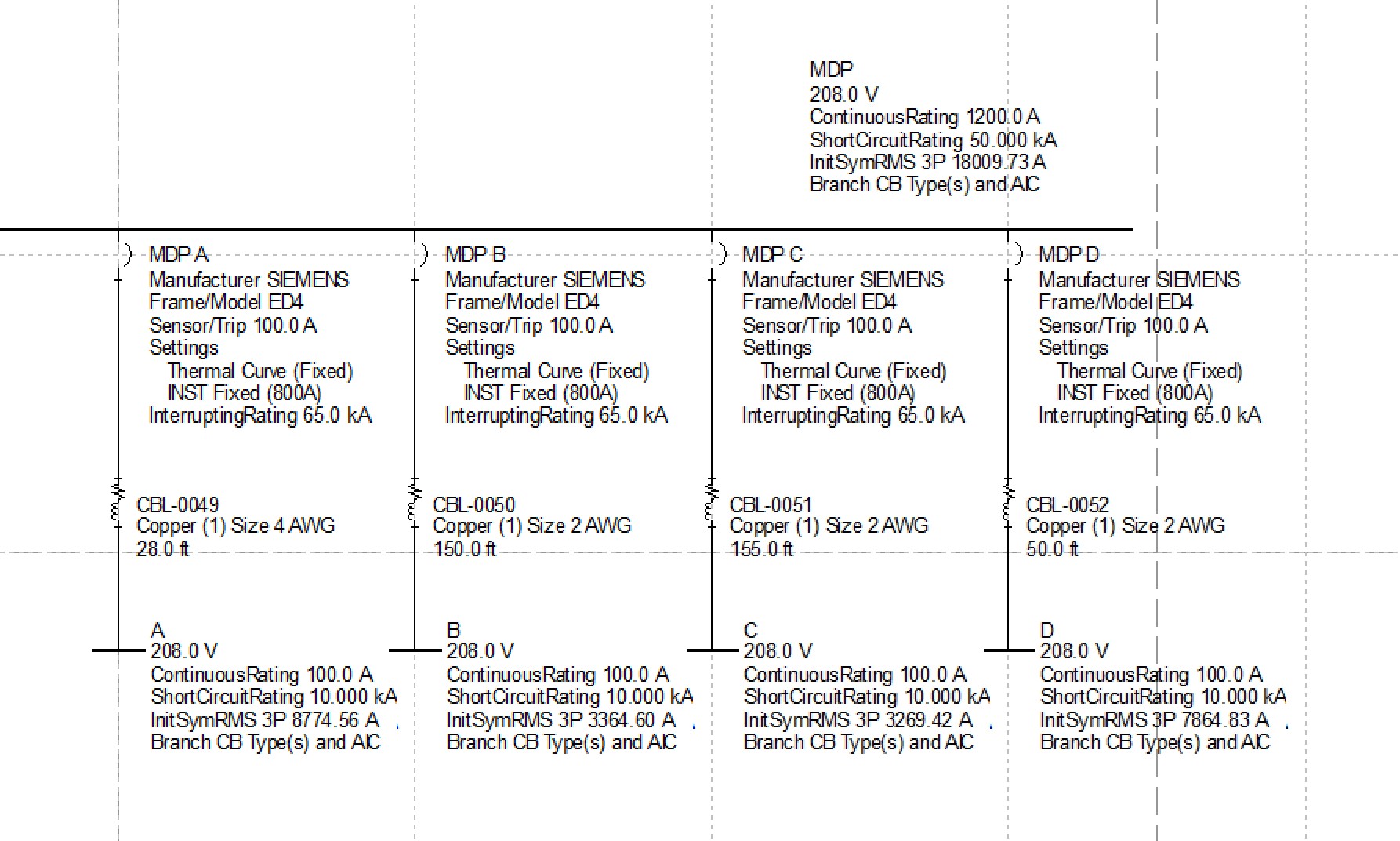

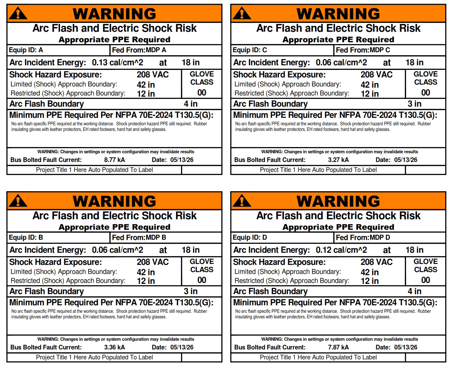

Posts: 492
This is what I was trying to describe:
