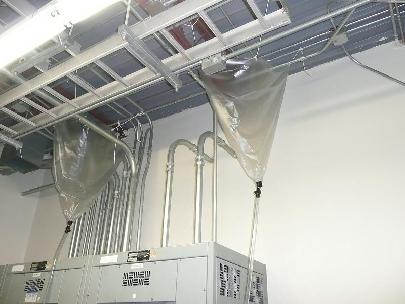

The AF values for the load and line side device could be the same because both the MCC main and upstream (from the MCC) breakers are the same mfg/type and have identical settings. Another reason could be the upstream protective device will trip before the main breaker (called mis coordination option in SKM.) This option will cause SKM to use the upstream device to determine the energy values instead of the slower Main breaker. This is why we put the protective device that was used to determine the energy level our labels.
