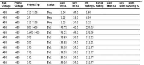

See the attached pic.
What PPE CAT and IE level should I label the 208/120 Panel?
PostPosted: Thu Nov 05, 2009 10:24 am
Posts: 1103
Well, what the study says, HRC 3. However, I would question these results, do you know all the info used for the calulation?

PostPosted: Thu Nov 05, 2009 2:13 pm
Posts: 40
See the attached for more detail, using IEEE 1584 study in SKM. Basically at the max clearing time of 2.0 Seconds.
Since this Xfmr is <125 KVA and it is 208V would you label it any different?
