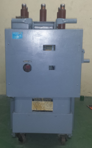

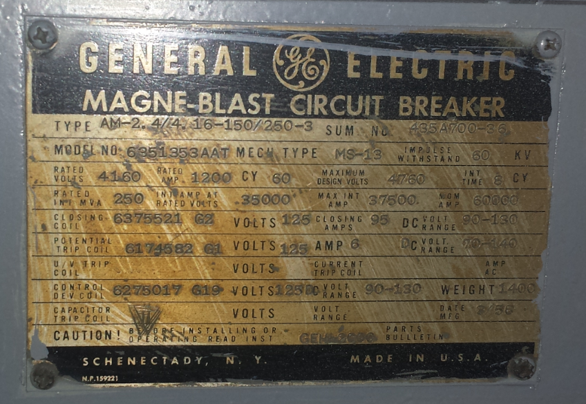

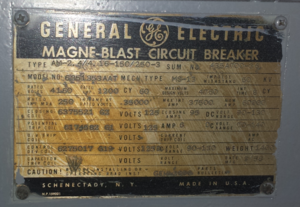

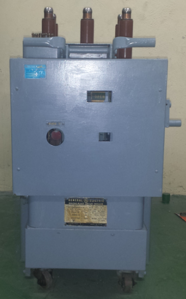

Recently on a visit to the company of a client, i met with a GE Circuit Breaker - Magne Blast from 1956 that still in operation. I attached some photos for you to watch it.
File comment: Magne-Blast - Plate
File comment: Magne-Blast Circuit Breaker
