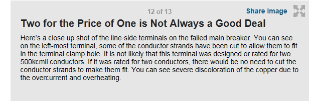

We have been seeing aluminum more and more so much so that in lieu of it being a VE by the contractor, when the project is started this is a conversation with the owner if they are open to the idea it becomes a required bid alternate at bid time, we have found if it comes in as a VE after the contract is awarded it is likely the owner will see a credit although not the same credit you would see under a competitive bid scenario. We see it specified / used in all facilities, from commercial to heavy industrial. Most of the automotive facilities [factories] have standardized on AL IAC in tray for bus duct, etc. Some will even use triplex-Tray Rated AL [XHHW-2] spaced to achieve the free air rating in tray, and most contractors will procure the cable from the distributor this way using colored insulation and pre-plexed on the spool with pulling heads already attached as to make the installation less labor intensive as a way to “sharpen their pencils�, in commercial buildings even the use of riser MC-AL. In most applications we see it limited to 100A and above, some down as far as 60A. As for the lugs not sure if “trimming the hair� is the right approach [I believe there was an article about this in a recent EC&M an investigative article], just being sure when you procure the equipment or are checking submittals/shop drawings you are getting the correct lug kit. Most breaker and panel manufacturers will have more than the standard lug kit available, or you could always utilize aluminum to copper pin-adapters, where lug size or the requirement for copper cable at the termination is an issue [some HVAC / mechanical equipment]. We have found as long as you have a good contractor competent in the requirements for the termination of aluminum cable there have been no issues, some owner allow the use of AL cable with the exception that all terminations are Cu using the associated Al-Cu pin adapters. The one place we have not seen allot of aluminum is in the MV world, still mostly copper EPR or sometimes XLP, however it is changing more and more.
I'll be more blunt. It is not only a Code violation but a safety violation for five reasons:
1. The ampacity is gone. If you have a cable with a certain amount of cross sectional area and you go and trim away part of the cable, guess what it isn't anymore?
2. Ever heard of "alpha spots"? At a joint contrary to popular belief only a small fraction of the available surface area in contact actually conducts electricity, known as alpha spots. At this point we need all the surface area we can get. So the contractor then takes away surface area. You can see this property in action in a variety of ways such as noticing that "cable failures" are almost never in the middle of the cable. They always start at the joints, even if it's a cable failure and not a joint failure.
3. The cable lug is designed for a specific amount of material to be present and actually crushes and essentially cold welds the materials together in order to achieve "intimate contact" and hence...alpha spots. Taking away material compromises this. Take away enough and you'll get a high resistance joint instead. Typically though this is an extreme problem.
4. What about the loose strands that remain? These will create electromagnetic fields (arcing, tracking, and other corona phenomena) which creates electrical noise as well as other problems if it is severe enough such as overheating at the joint, although this is mostly a bigger problem at medium voltage.
5. The mechanical properties are compromised. So under fault conditions the joint can fly apart.
Simply put, "trimming the hair" should be tantamount to trimming the work force.

PaulEngr just to clear this up In no way was I condoning this practice it was just sarcastic reference to wbd’s comment above about the practice of the "haircut", hence why I expanded on options to terminate aluminum conductors [procuring the proper lug kit, pin terminals, etc.] the image below is reference to the EC&M article from the April issue.
I thought so but sarcasm doesn't come across in print form very well, so sometimes it's hard to tell. I can honestly say that most of the flagrant hair trimmers don't even realize the problems they cause, even if they go back to the exact same spot and repair the same cable all over again, and trim it in exactly the same way.
And personally there is nothing more aggravating when it comes to terminations than stuffing welding cable or DLO down into a crimp on lug and crimping it down only to find that one little strand didn't make it into the lug and having used up the last lug in the box.
