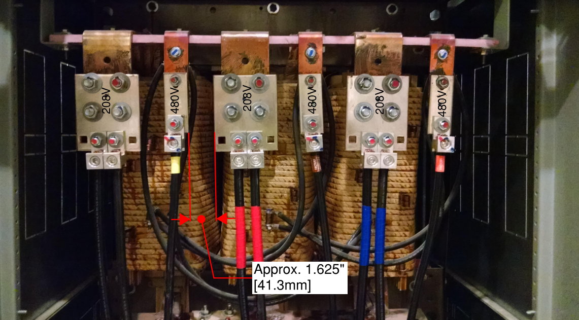

Ahh good question I have to say in previous studies I have seen locally they all include labels on transformers then I started to questioning the method in the way the IE was calculated when I would see “gap” distances varied from study to study or even on the same study either switchgear, panel, or cable connection, some based on the 208V some on the 480V some indicating the “worst case” between the two calculations digging into this further understanding on how the values change as the variable changes in the IEEE formula….After reading other form responses and talking with some end users, owners and electricians, I have come to the conclusion that they [low voltage dry type transformers] should not be labeled with anything more than the generic label indicating “Warning Arc Flash and Shock Hazard Present When Energized” other than that how to you calculate a value of incident energy and still protect your liability [always have to keep the lawyers in mind] when there is no defined standard to back up you assumptions…Even understating the “gap” for each transformer design from the manufacture this information can be gathered, however as previously forum member stated the primary and secondary terminations are typically intermingled H1, X1, H2, X2, H3, X3, XO in the low voltage dry’s with no physical separation between them so even if you know the “bus gap” if measured or provided by the manufacturer how do you go about calculating the IE? The commercially available software I have seen to date provides you a Primary Node or bus and a secondary Node or bus but dose not accurately reflect the construction of the transformer configuration with both primary and secondary intermingled in a common enclosure. I do agree when dealing with liquid pad mounts with live front they are typically barbered however because of the door construction and how they overlap you typically have to open the low voltage side to get to the primary but at least it is has an internal barrier and you can calculate both side individually, the same with a low voltage substation if you are terminating in the air terminal chamber with remote overcurrent protection then the voltages are physically isolated and a label could be applied.
Either way I think since there is no standard to back up [legally] how one calculates a dry type with intermingled voltage terminations, and varying “bus” gaps based on size and manufacturer I would recommend avoiding the practice unless the owner has written published standard on how they want the equipment labeled. At least with equipment like transfer switches, large contactors, etc. the bus gap can be defined either by field investigation or published data by the manufacture and your voltage is typically limited to one voltage source the low voltage dry type transformer is a another animal…The only question remains as indicated by another member is how to you dress to verify the transformer is de-energized??

So then a follow up question for those more involved with the 1584 standard, research and updates, etc. Has IEEE performed or is there any proposed testing in the works to simulate this condition? A box of a specific dimension with both energized 480V& 208V bus bars at a specified distance to see what happens in an attempt to extrapolate the data into a formula similar to the way the current calculations were created, to provide some guidance on the low voltage transformer discussion or is this more of a manufacturing thing by having the manufacturers providing insulated bus bars to individual compartmentalized sections of the transformer essentially isolating LV from HV bus and terminations like a MV Xfmr. That would then utilize a more standardized bus gap arrangement based on the voltage in that compartment alone??

So I came across this installation by chance and decided to check for reference, and figured I would share my findings.
That's one out of how many different configurations?
I'm going to stick with not labeling them and our "shut it down if it's not labeled" policy. I'd rather do that than put a sticker on it with the wrong data.
As mentioned before, a generic DANGER - SHUTDOWN REQUIRED would also work over putting a label on it with arbitrary or erroneous IE and PPE listed.
