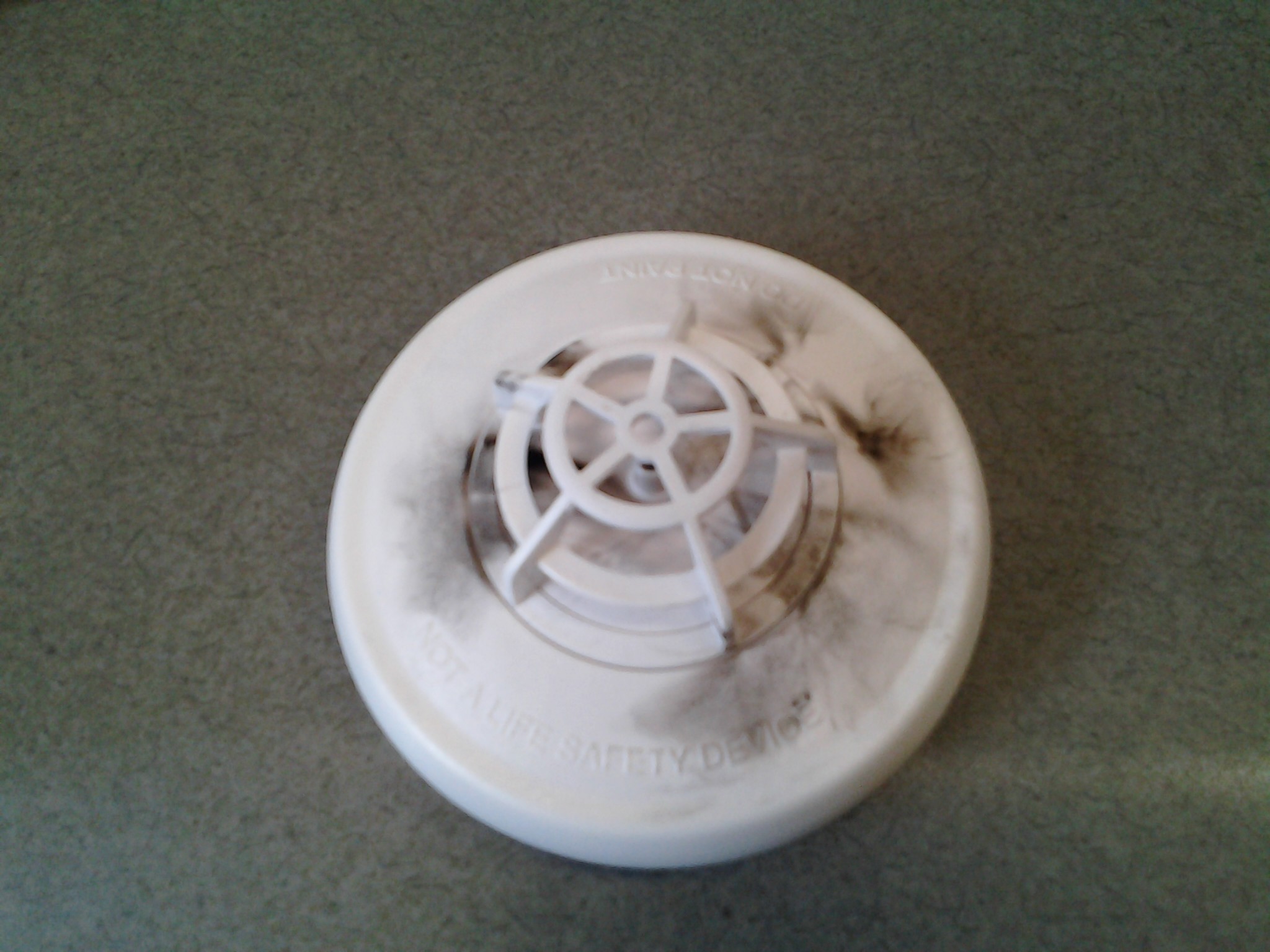

I saw a heat detector catch on fire during testing once. Does that count?
We were doing a new fire alarm system acceptance test. We don't use magnets. We test smokes with smokes and heats with heats etc. We had one of those cup style testing poles over this detector. It was taking an unusually long time to go into alarm. I looked up at the transparent cup and saw a glow inside. Yikes!

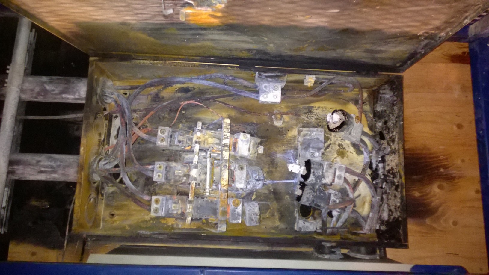

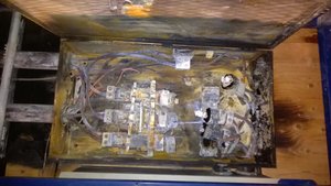

The facility was trying to do the correct thing with Thermography scans. Except this box could not be worked on unless the utility company removed power to the facility. This feel through the cracks and ~6 month's later, we had an incident. Other than the box and the plywood it was mounted to, no significant building damage.
