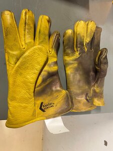

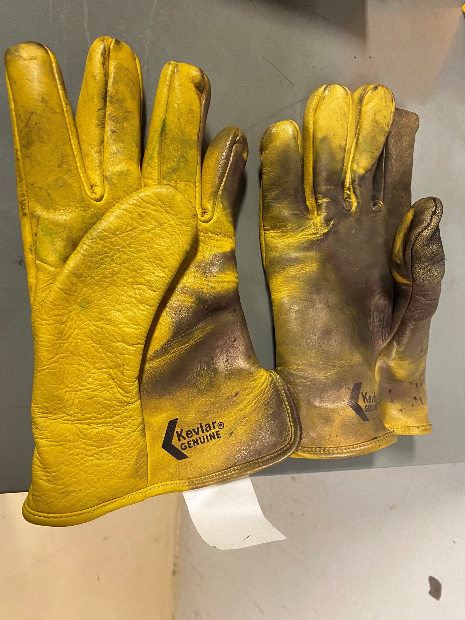

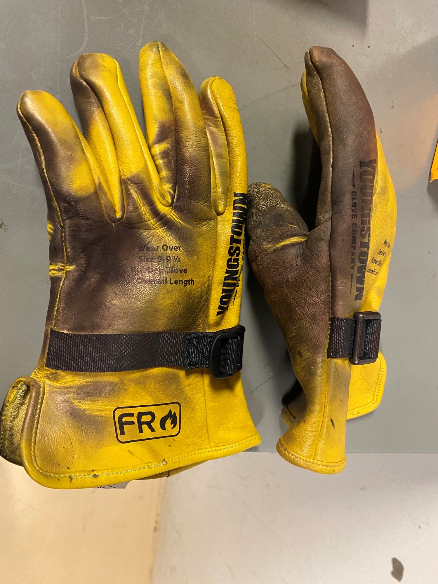

Obviously the stats for this new leather protector sound pretty impressive but the proof is always in the pudding. Back in March of this year (2021) we had a significant arc flash event inside one of our 480V MCC buckets. Thankfully no one was injured in the incident and it's root cause was 100% human performance related. But since the topic of this thread is AR gloves and protectors, I won't go into all the details and contributing factors surrounding the incident but rather the performance of the PPE product for hand protection.
This particular MCC has an IE of around 5 cal/cm2 at a working distance of 18". The electrician involved was wearing a 40 cal/cm2 arc flash suit and hood combined with class 0 rubber insulating gloves with the new AR leather protectors for the hands. When the arc flash occurred, the electrician's hands were well within the working distance and literally at 'ground zero', meaning less than an inch from the arc source. The exterior portions of the AR leather protectors suffered significant burns, charring and external damage to large areas, especially of the right hand, right thumb and index finger. However, the majority of heat energy was blocked by the leather protector's construction combined with the added insulating value offered by the rubber glove itself. Consequently, the individual involved did not receive even a first degree burn to his hands or fingers. A visual inspection of the interior portions of the gloves and especially the fingers, showed no discoloration of the yellow Kevlar liner nor did the fingers of the rubber gloves indicate any exposure to thermal energy.
Based on this incident, I'm a firm believer of the value for transitioning away from traditional leather protectors to a product that provides electric shock protection and a known arc flash protection with greater resistance against punctures and cuts. Not good a good day if the wire strand that punctures your protector is energized.
File comment: Awesome performance x2
