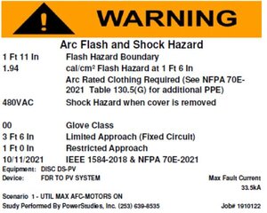

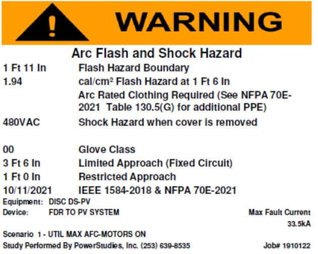

We also include the following items:
1. Our company name.
2. Our company phone number.
3. Our Job #. (this is helpful for when we do a AF refresh study after 5 years.)
4. Maximum available fault current.
5. Standard Version used to calculate the AF energy and boundaries.
 Post subject: Re: Arc Flash Label Data - Revisted
PostPosted: Mon Oct 25, 2021 1:04 pm
I would add that Robert's example above also contains an ANSI signal word and symbol.

Having the maximum available fault current is a huge plus. I think by adding that number people will gain a much better appreciation of what arc flash energy is all about. Strangely, too many people order gear without even knowing what the available fault current even is.
