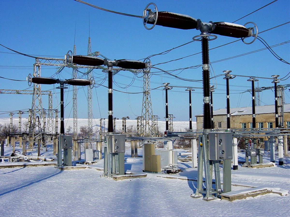

What is best practice to evaluate outdoor high voltage equipment? In this case it a 300 kV overhead line and circuit breakers. It is quite similar to the ones showed on the picture below. This means that the service cabinet is available accessed during operation. A fence closes in the area. This is in Europe.
1. Would it be good practice to do a calculation and establish a cal/cm2 level? On the other hand, is this just way out of normal practice for these kind of operations? (Then I use the working distance from ground level)
2. The operator is also being curious about the arc flash boundary. Since there are many workers inside this fences during projects. They have no electrical skills or protection. Is this relevant?
3. I am considering to use the Lee equations for this? As I understand this would give very conservative results (I have a software that uses Lee for this kind of voltage). Have anyone done anything similar? Is this normal in the US?

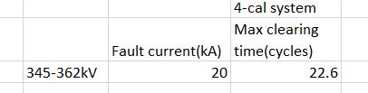

Thanks for answer you are right it suppose to be C2 :)
In general it thought the arcing time has to be included since the arc flash would be presented until the current is totally blown off(not just use open time for the CB?)
But my real question is do I understand the table 410-2 correctly? Can I round up to fit the voltage?
And is the 2.7m correctly understood?
The Lee equation's gives higher values at the same input

 Post subject: Re: Arc flash study on 300 kV outdoor
PostPosted: Sat Feb 03, 2018 6:17 am
The clearing time of the circuit (breaker, relay, LOR) is the arcing time. The arc starts, relay senses, sends trip signal, breaker opens, all that time until arc is extinguished is the arcing time.
The table in C2 was created by use of ArcPro. ArcPro's inputs are current, duration, arc gap, source voltage, distance to arc. The source voltage is basically a check to see if the voltage would sustain an arc. The arc gap is the L-G voltage divided by 10 (dielectric strength of air is 10kV per inch).
So for your voltage, I would use the voltage range in the table which would have the arc gap closest to the arc gap at 300kV.
230-242 kV, arc gap: 13.3-14 in
345-362 kV, arc gap: 19.9-20.9 in
300 kV, arc gap: 19.1 in
So the 345-362 kV range utilizes an arc gap closest to the one used for 300 kV. I think that as long as you are outside the minimum approach distance the incident energy level will be well below 4 cal/cm2.
