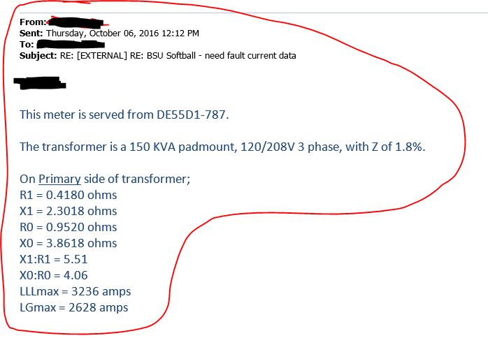

I feel for you. Not to rub salt in the wound, well maybe a little. I feel fortunate. Here is an email from our utility when I asked for the same info as you on a facility that is not connect to our campus distribution system but is just a bit off campus that I modeled a couple years ago.
They've also sent me screen shots of their models including trip curves before without any resistance to the request at all. Of course, it may have something to do with the fact our peak demand each month is generally well over 20 megs and our bill is in the millions annually. We're a pretty large customer for them so they treat us pretty well.
... well thanks for that :)
I must clarify though that I've never had this level of ignorance from a Utility, and we've done hundreds of Studies over the past 5 years. The Utility in this case reiterated their position with the following:
