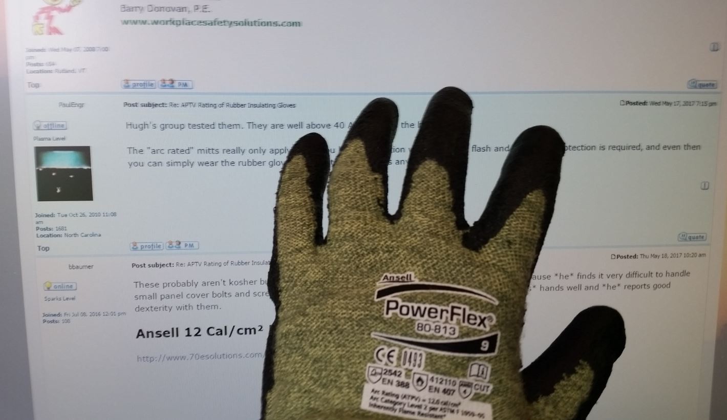

These probably aren't kosher but I *might* know someone who wears them while surveying because *he* finds it very difficult to handle small panel cover bolts and screws when wearing leather gloves over rubber gloves. They fit *his* hands well and *he* reports good dexterity with them.
Ansell 12 Cal/cm² PowerFlex 13 Medium Duty Work
http://www.70esolutions.com/ansell-12-cal-cm-powerflex-13-medium-duty-work/

 Post subject: Re: APTV Rating of Rubber Insulating Gloves
PostPosted: Thu May 18, 2017 8:27 am
Posts: 497
Another pic, this time time an actual close-up:
