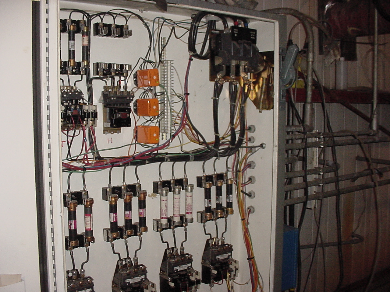

What electrode configuration would you use?

Fuse clips could be VCBB or HCB. At the breakers and motor starters it is VCBB. All else being equal, if you run the calc's on both VCBB and HCB, HCB will give you the higher incident energy. So I would use HCB.

vCBB unless the dimensions work out to shallow which this has to be close. Due to enclosure sjze VOA might be more appropriate though. When does CF reduce VCB 5o equal VOA?

I tried varying box sizes with the IEEE1584 Excel Calculator and found that with 480V, 20kA bolted fault, 1" gap, 24" working distance, 200 ms arc duration, VOA gives 2.15 cal/cm². Increasing box size from 20"x20" to 60" x 60" in 5" increments, results in IE reducing from 4.56 cal/cm² to 3.44 al/cm² at 50" x 50" and not reducing for larger sizes.
Most likely that interpolations too far beyond the tested sizes to not result in values approaching the open air case.

The adjustment stops at 1244 mm.

No doubt this is a more complex model than the 2002 edition. When the 2002 edition was published, it was a new calculation model and users where initially uncertain of what to do with it. (which is why I began this forum back in 2007) Then people began publishing technical papers about experiences using the model and the application became more routine.
The 2018 model created a similar situation and as before, technical papers where presented based on user’s analysis and application experience. Many software providers had active representation on the committee and subsequently integrated this into their software complete with defaults which can be changed if someone wants to.
The "theoretical" part of this - electrodes in a box etc. is for test repeatability within a controlled environment. The different electrode configuration where the result of what was learned since the 2002 standard.
Some application guidance for real world cases IS found in Section 6 of the 2018 edition of IEEE 1584 which includes photos of equipment to identify VCB, VCBB, HCB etc.
It's now been almost 3 years since the 2018 standard was published and most that were previously familiar with arc flash studies have adapted to the 2018 model which provides much more modeling flexibility.
