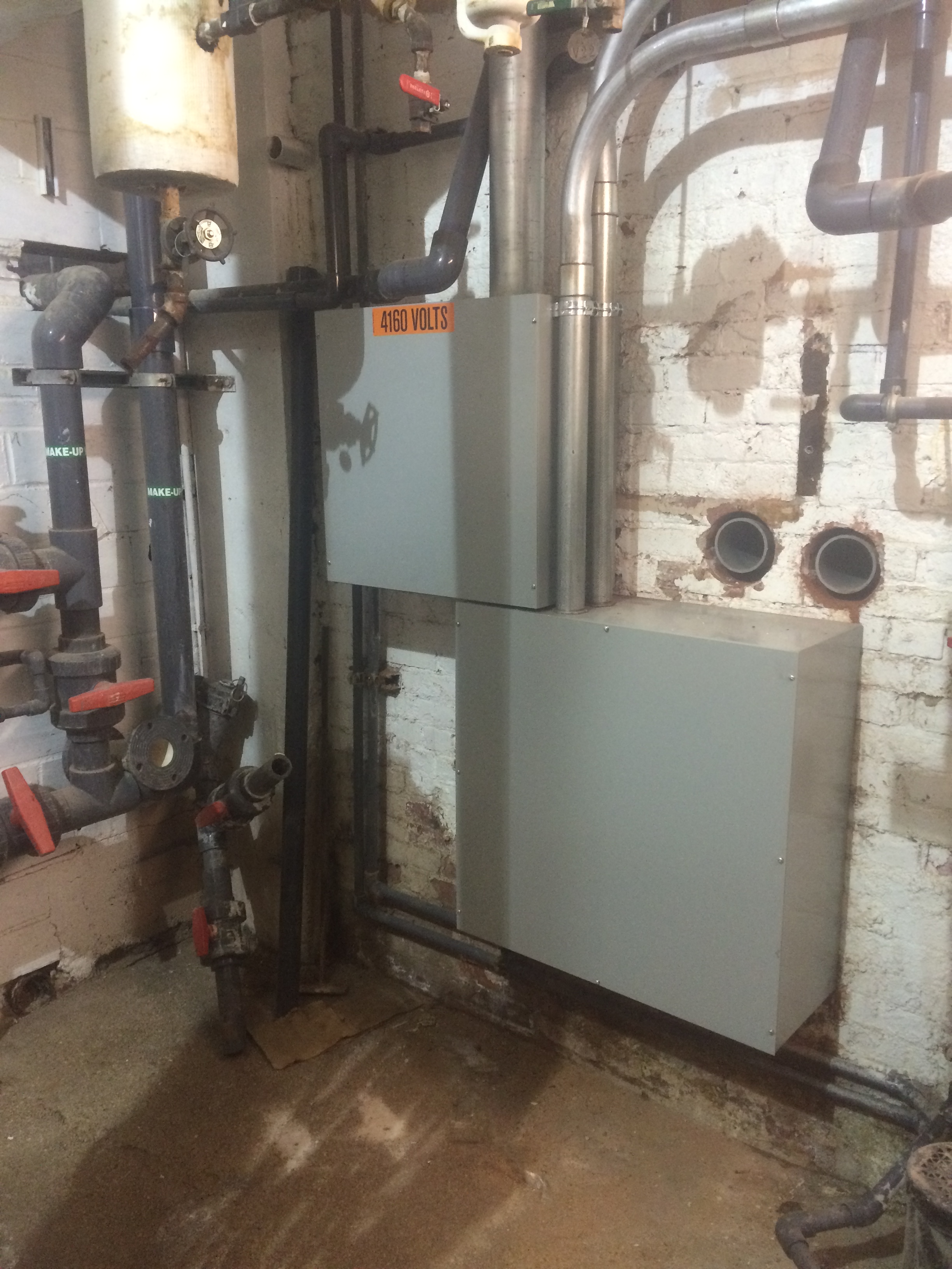

See attached for a common item I run across at our facility - 4160V, 480V, 208V, pull boxes with screw on lids that are not identified. Many have the voltage warning label but not much else. Should I be planning to label such clearly accessible boxes with arc flash labels?
I realize that NFPA 70E Table 103.7(C)(15)(A)(a) doesn't require labeling assuming all is well, but if I was investigating a circuit path I'm sure I could wind up needing to get into this box without being 100% sure of the circuits inside nor of what kind of condition the wiring methods are in inside. What would you do?
Thanks,
Brian

See NEC 110.16: " Electrical equipment, such as switchboards, panelboards, industrial control panels, meter socket enclosures, and motor control centers that are in other than dwelling units and are likely to require examination, adjustment, servicing, or maintenance while energized shall be field marked to warn qualified persons of potential electric arc flash hazards. The marking shall be located so as to be clearly visible to qualified persons before examination, adjustment, servicing, or maintenance of the equipment."
Two key concepts here. The first is the phrase "such as". The equipment list is an EXAMPLE, not a comprehensive requirement.
For instance disconnect switches, especially the fused variety, are not included on the NEC list but clearly meet the definition of requiring maintenance.
The second concept is that it is LIKELY to require some kind of work while it is energized. As an example it is not standard practice for most plants to open and service a motor peckerhead while it is energized. In this case a peckerhead does not require a label.
A true "pull" box where wiring merely runs through a box without termination within the box also typically doesn't require servicing while energized so again, no label.
But where we get into equipment that has terminals and/or junctions which is specifically designed for servicing clearly would require a label if it is serviced while energized. Again this does somewhat depend on what your plant practices are.
A final concept is that of time. Even if equipment under consideration meets all the requirements above when it is being serviced if you have equipment that rarely gets servicing of any kind (say at least a year or more between servicing), then it may not meet the definition of likely. For instance it would not be unusual to find some kind of panel such as say one that has terminals that allow termination of a cable that is only allowed for underground service to one that is rated for more general purpose service that is rarely opened or serviced in any way.
The whole concept here is that electricians should NOT have to go pull the single line prints and check what the incident energy is (or ask someone else who is qualified to do so) the vast majority of the time but it is acceptable if this happens on an infrequent basis.
Many plants have some kind of "default rule". Usually this means that for instance the assumption is that any unmarked panel is automatically considered 1.2 cal/cm^2 and may or may not also have an automatic voltage assumption, or that unmarked panels are to be treated according to the tables in 70E instead of following the label. Having a default rule like this drastically reduces the number of panels that have to be labelled but there are two caveats to it. The first is that the tendency is that if there's no label, have at it...don't think about the consequences. The second caveat is that a label can be missing, obscured (depending on the approach), or simply missed during the last labeling campaign. Thus the correct result is to use the follow up mechanism but with a "default rule", this does not happen.
Frequently the "default rule" is used in conjunction with a very strict interpretation of the NEC label rule though so that for instance a lot of "utilization equipment" (loads and boxes associated with loads) does not get a label. Only the distribution equipment (panelboards, MCC's, switchgear, disconnects, and similar equipment) gets a label.
The reverse case (label everything) also has a downside. This means that most plants will have a huge number of "lighting panel labels" with a label that basically says the panel is not a significant hazard. If it looks like all the other labels, the tendency will be to get complacent and ignore arc flash labels altogether.
