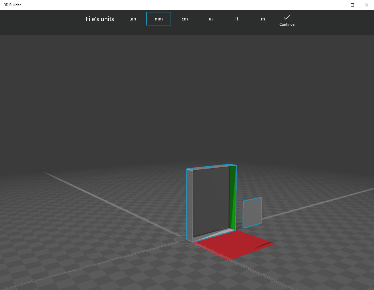

Did Wilkins assume that all arc energy irradiating the inner enclosure surface was either reflected or absorbed/emitted back on the calorimeter? That was the assumption I was making when doing some practice work on 1 surface at a time, that the surfaces did nothing but redirect energy (reflect and emit) and nothing was absorbed. The only arc energy that doesn't make it to the calorimeter was due to a zero view factor. Also that the calorimeter doesn't emit anything back to the enclosure.
I attached a 3D image of my model so far. There's a "grey body" setting in View3D that I figured needs to be on for our scenario. Any idea what would be optimal dimensions for my receiving plate? I was thinking a 10"X10" area right where the sphere is tangent to the calorimeter (or person standing 18" away).
Wilkins did no such thing. He modelled the source as a disk with radius R and simply scaled the disc size and I think a proportional constant (calibration factor) until the two parameters perfectly matched the experimental data from the IEEE 1584 test data set. You are already way ahead of this. If you keep the proportionality constant and the rest of your model "works", whereas Wilkins just "fixed" IEEE 1584's purely exponential model of enclosures, yours can simulate any enclosure.
As to reflection, all real world objects are "grey bodies". A black body is a theoretical object that absorbs energy regardless of frequency or angle of incidence. A white body is a theoretical object that has a rough surface and reflects energy regardless of frequency or angle of incidence. Black body radiators emit radiation according to Planck's law in all directions uniformly at all frequencies. A black body has an emissivity of 1.0. A grey body is basically a black body except that the amount of radiation (and reflection) is a fraction of the black body case, modelled with the emissivity constant. Note that emissivity is frequently treated as a constant but it is actually a function of material, temperature, and frequency of the emitter, and incident angle really does matter. Don't try to model this though...just accept that emissivity is not a nice simple number. This is one of the reasons that "IR scans" are not as simple as it appears.
