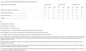

Hi,
I am wondering if anyone else is experiencing delays in receiving ARCPRO software? It has been 6+ weeks since our order was placed, and Kinectrics will not provide an update on delivery. At the time of quote, I was told 4-6 weeks.
My understanding is the supplier in the USA is HD Electric, and in Canada the supplier is Young Utility Equipment. Both suppliers have said that the software comes from Kinectrics, so whether our US office purchase from HD electric or the Canadian office purchases from Young Utility, the delivery would be the same (4-6 weeks)
We need ARCPRO to comply with OSHA 1910.269 table 3 for calculations above 15kV....but that is difficult without the software being made available to customers willing to buy it.
Thanks,

Probably reverts to Lee at 15 kV if it even goes that high. As OSHA noted, Lee gives extremely conservative results at higher voltage. ArcPro is the only reasonable show around for 15 kV and higher.

It all sounds good except for the fact that there isn't any test data above that voltage. So OSHA's "analysis" is that Lee gave very high results, and Duke heat flux gave very low results, and ArcPro was right down the middle.

The issue becomes if you are trying to meet OSHA 1910.269 for making a reasonable assessment of incident energy for electric utilities. OSHA provides a table in Appendix E which lists what OSHA considers as methods which provide reasonable estimates of IE and the only method listed for >15kV is ArcPro. OSHA would probably accept another method, such as ARCMASTER, if there is documentation showing the two methods are comparable. So, IMHO one might as well use ArcPro and save a headache of trying to prove to OSHA the other method is equivalent.

Thank you for all your comments regarding other software options, but OSHA will only accept ARCPRO over 15kV as per Table 3 in the first post of this thread.
I have used ETAP for the rest of the facility with no issues. I also used ETAP for the calculation above 15kV (Ralph Lee Theoretical Calculations), but according to OSHA Table 3 this is overly conservative and is not acceptable. See note 3 of Table 3.
